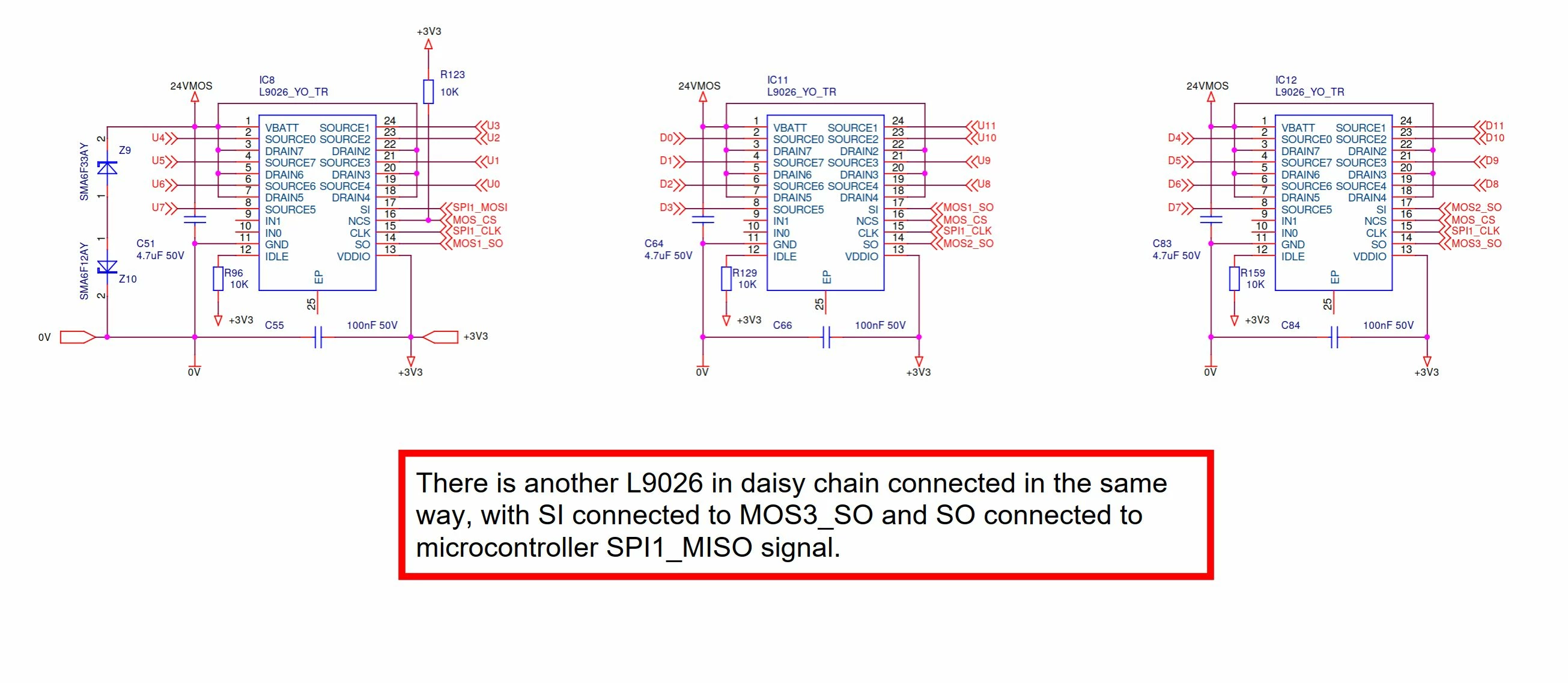

Good morning all, I have a board to test with n.4 L9026 in daisy chain, driven with a microcontroller STM32G0V1ET. Unfortunately there are no examples on ST website and I am not able to switch on outputs. Any idea?

Sorry, there was an error due to copy/paste, line "data16=0b1010000000000000;" now removed.
Now outputs are active, even if only SOURCE1 (SOURCE0-SOURCE7). I am investigating...
