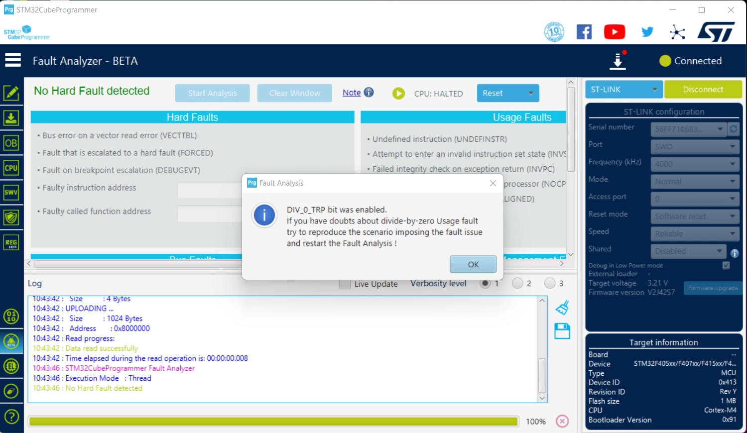

Fault occurs only when input is given through uart  and at the same address only. when testing through Beta Analyser in Cube Programmer I got following prog.png
But I dont think I have any condition where anything is divided by zero.

Looking at the code and registers at the fault would be the most enlightening.
