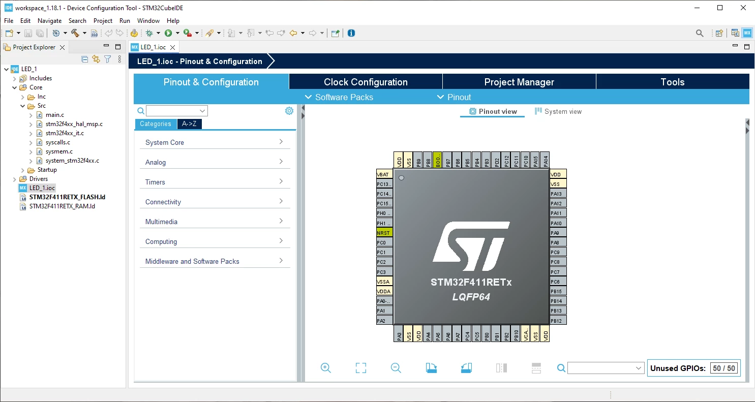

Getting started working with STMCude IDE and use C++ for my Nucleo board
Installed STM32Cubde IDE on my machine and selected my board.
I was expecting some of the pins/peripherals are set by default but as shown in the screenshot they are not.
How to fix this issue please?

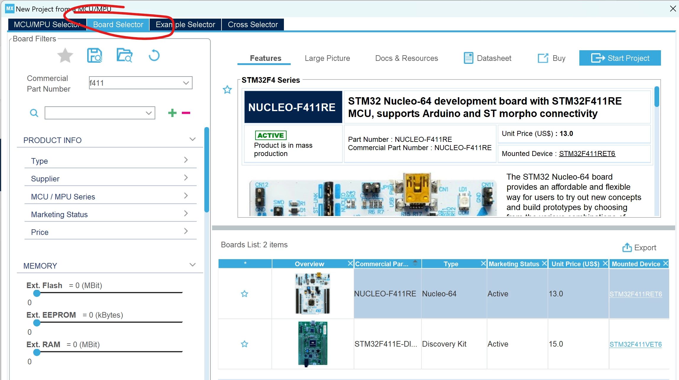

TDKBest answer
May 26, 2025 10:51 PM UTC
Use the Board Selector, not the MCU Selector.
You can use either one, but if you want peripherals auto-initialized, you have to use the board selector and select the board you have.

May 26, 2025 7:44 AM UTC
Hello @unknown and welcome to the ST Community.
I think you didn't click on the "Yes" button on the Initialize all peripherals with their default Mode message after clicking on the finish button.

STTwo-32
May 26, 2025 9:29 AM UTC
Hello @STTwo-32  and thanks.
I guess I clicked on that button but since it's my first working project I may have got wrong.
Is there any solution to fix that issue now or should I delete that project and create a new stm32 project from scratch please?
Also, why are the header and source files in C while I selected C++ as the target language?
I think there should exist the C++ version of the libraries. Not?

May 26, 2025 11:41 AM UTC
Deleted the project and also checked "delete project contents on the disk", then created a new stm32 project named LED_2. Now the peripherals are properly initialized by default.
