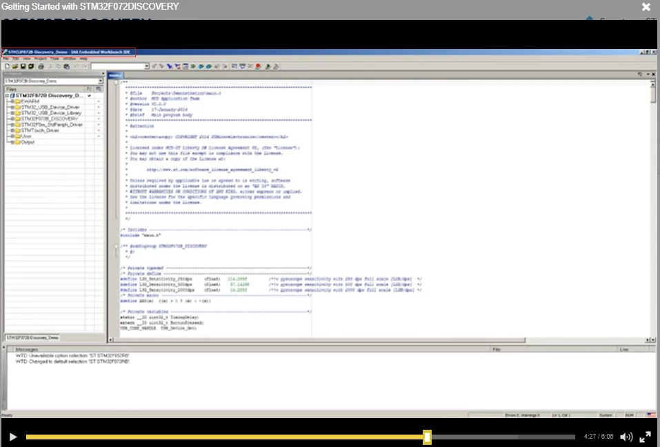

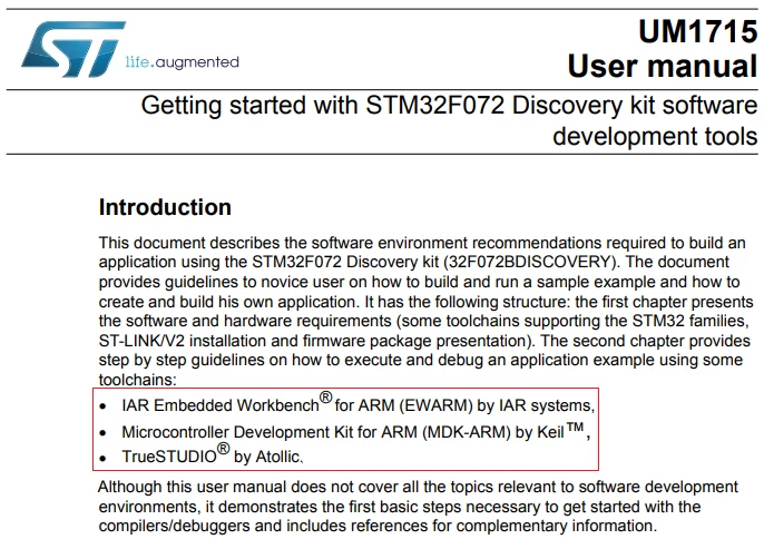

I am new to the STM32 Discovery boards. I've chosen the STM32F072B-DISCO as my Discovery kit and am currently exploring how to begin developing applications with it.
As per the 'Getting Started with STM32F072DISCOVERY' video and the UM1715 User manual, the software development tools mentioned are IAR Embedded Workbench, Microcontroller Development Kit for ARM (MDK-ARM) by Keil, and TrueSTUDIO by Atollic.
Could you please inform me if the board is compatible with the ST Development tools such as STM32CubeMX and STM32CubeIDE? Could you kindly assist in identifying the IDE and SDK, along with a sample application, in order to kickstart the development process?
