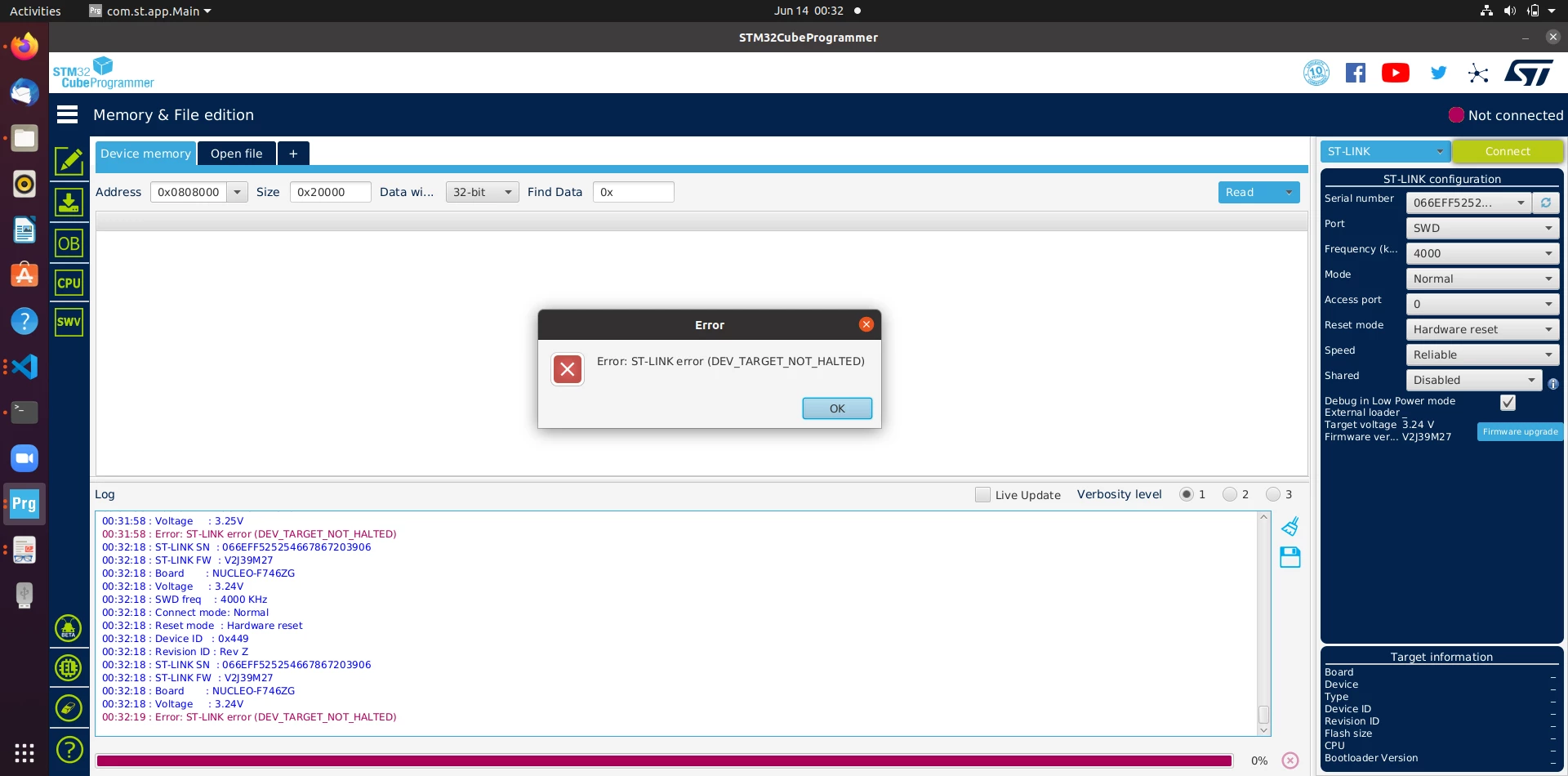

Getting error like "Error: ST-LINK error (DEV_TARGET_NOT_HALTED)" after flash sector erase.
Hi all,
i am using stm32f746zg board, after sector erased i am trying to connect cubeprogrammer but device is not connecting. please find attached file for more information.

Hello @UHida.1​ ,
Check your USB cable, connectors... , try connect in "under reset" mode.
Which CubeProgrammer version is used ? Please make sure to use latest release.
Maybe this post helps you !
