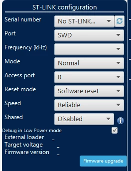

Heya!
I've been borrowing an STLINKV3MINIE and today my own (legitimate) STLINK/V2 arrived today, but I haven't been able to detect it. I purchased the product from Mouser (https://au.mouser.com/ProductDetail/STMicroelectronics/ST-LINK-V2?qs=H4BOwPtf9MC1sDQ8j3cy4w%3D%3D&srsltid=AfmBOooS1jAwuhdu3ZF7xo5hJ7OWAqrWYGnkUSL7hzKZPl6fvURN-Hnq).
You can see in device manager, when I have the V3MINIE connected, it shows in the DM panel:
When I connect with the V2, my computer does recognise it:
I have been using the same USB port on my computer, and I am using the cable that arrived with the V2 to connect it. The red LED on the V2 is on (remains red, no flashing), but I'm getting nothing.
When I try connecting to it via STM32CubeProgrammer with the V2, I get nothing (Verb level 3):
It does not detect the Serial Number and doesn't show up as something to connect to in the cfg panel:
It works A-OK with the V3 as soon as I plug that back in (same settings), but not with my V2.
I had downloaded the V2 driver from here (https://www.st.com/en/development-tools/stsw-link009.html) and followed the README.txt, but nothing had changed.
Any help would be much appreciated.

The original cable packaged with the board was not holding a stable connection. I used a different cable and updated the firmware. Then the original cable worked fine.

Sorry, I had not realised the V2 did not appear as a COM port. I can confirm that it appears in the USB section of DM:
Not a solution, just something I had realised afterwards.

on which system ? Win ? (btw   Never seen this problem.)
Maybe some kind of "rights" is a problem, so check /disable firewall, virus scan, owner etc. - then try.
AScha.3
Dec 14, 2025 3:30 PM UTC
... Or try Menu - update st-link in Cube Programmer , maybe this helps.
