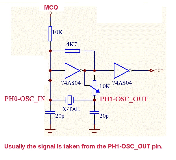

From which output of the Crystal oscillator is the signal for clocking the microcontroller taken?
STM32F407
_legacyfs_online_stmicro_images_0693W00000biXIdQAM.pngUsually the signal is taken from the PH1-OSC_OUT pin if it is a parallel resonant oscillator circuit.
The signal for clocking the microcontroller is formed on the Crystal oscillator X2, fed to the microcontroller and amplified in the microcontroller.
If so, why is PH0-OSC_IN also connected to the microcontroller?
The MCO(PH0-OSC_IN) signal is needed only to generate a signal on the Crystal oscillator X2, why is this signal fed to the microcontroller?
If you disable PH0-OSC_IN from the microcontroller, then the signal from the Crystal oscillator X2 will continue to be fed to the microcontroller via  PH1-OSC_OUT.
Why is PH0-OSC_IN connected to the microcontroller then?

In your 2nd picture there is only a passive crystal which does nothing on its own, only with the MCU's internal "amp" it's becoming an oscillator. Both IN and OUT are needed to create a positive feedback loop to keep it oscillating.
If you are using an external active oscillator (which usually has voltage supply, GND, and an output), then you connect it only to the IN of the MCU - and must set that in software accordingly (HSE_BYPASS or so).
The external active oscillator basically consists of a crystal and the amplifier circuit integrated in the MCU, usually with a stronger driver.

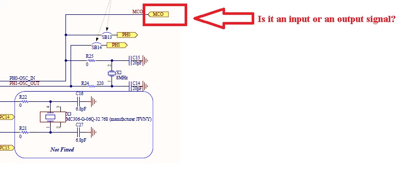

_legacyfs_online_stmicro_images_0693W00000bkToUQAU.pngIf this is an input, then why does the Pierce generator need a signal on PH0-OSC_IN?
The Pierce oscillator generates a signal using an inverter, a quartz resonator and capacitors.
MMust.5
MMust.5Author
Senior
May 20, 2023
MCO - Main Clock Output.
I don't understand the signs very well.
MCO should be an output, what does the yellow MCO arrow pointing to the microcontroller mean then?

There is such a description, but it is not clear from it exactly where the MCO signal is generated.
The description says: MCO from ST-LINK. MCO generated in ST-LINK?
MCO from ST-LINK: MCO output of ST-LINK MCU is used as input clock. This frequency cannot be changed, it is fixed at 8 MHz and connected to PF0/PD0/PH0-OSC_IN of STM32 microcontroller.

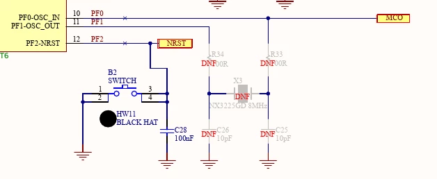

on some newer boards the circuit is clear: (nucleo-G0B1RE MB 1360 )
_legacyfs_online_stmicro_images_0693W00000bkU9rQAE.pngclk coming from st-link MCO and other parts not fitted.
but to try, can fit missing parts and open SB17 , then local crystal is clk source.
