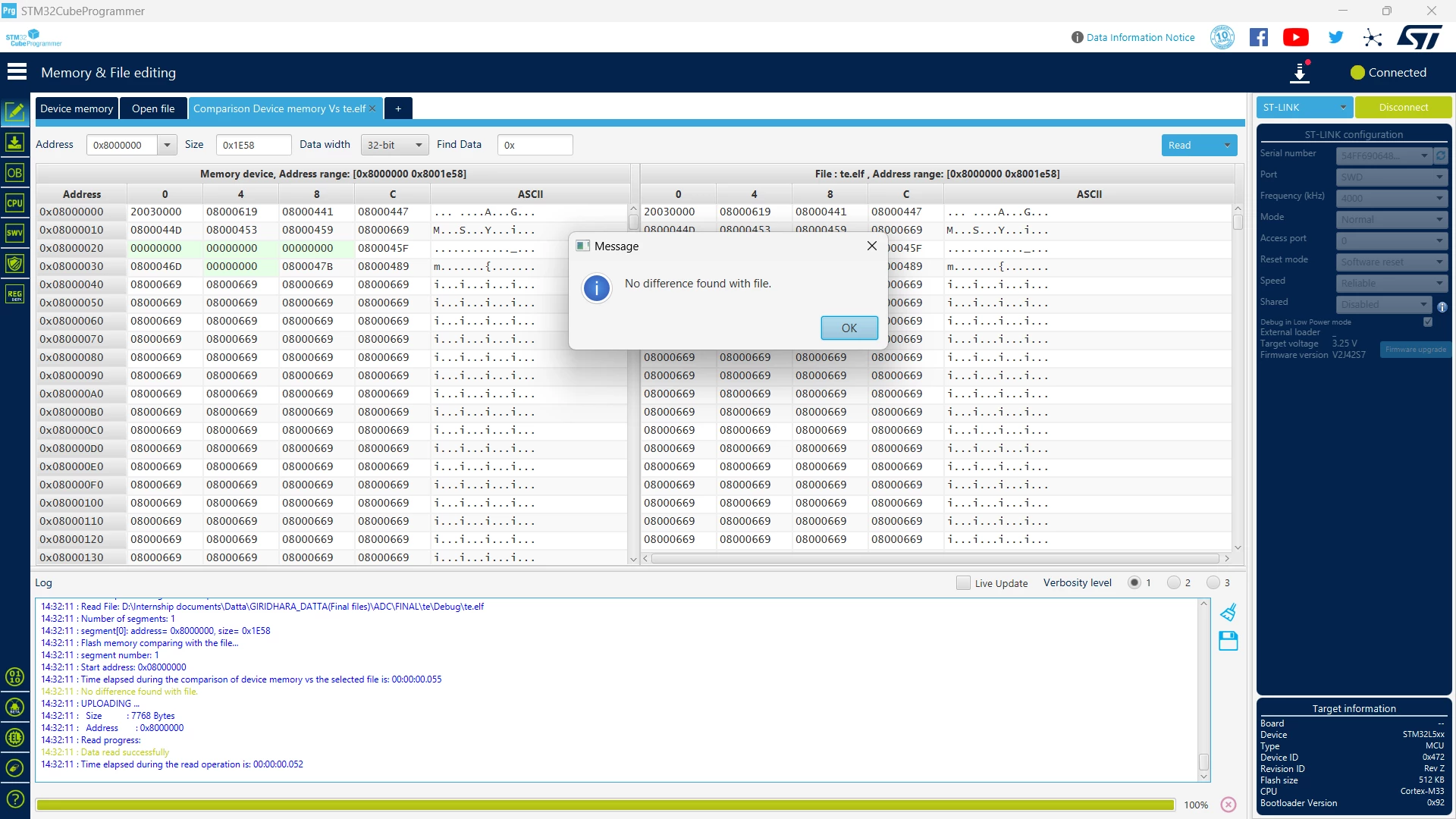

How are you sure the program is erased? did you check the flash content with STM32CubeProgrammer for example?

No I'm sorry It's not getting erased physically..Screenshot 2024-04-01 143229.png
As you said the program is not starting after the power off and on.
And also as I observed now , the program is getting halted even I i press the reset button.

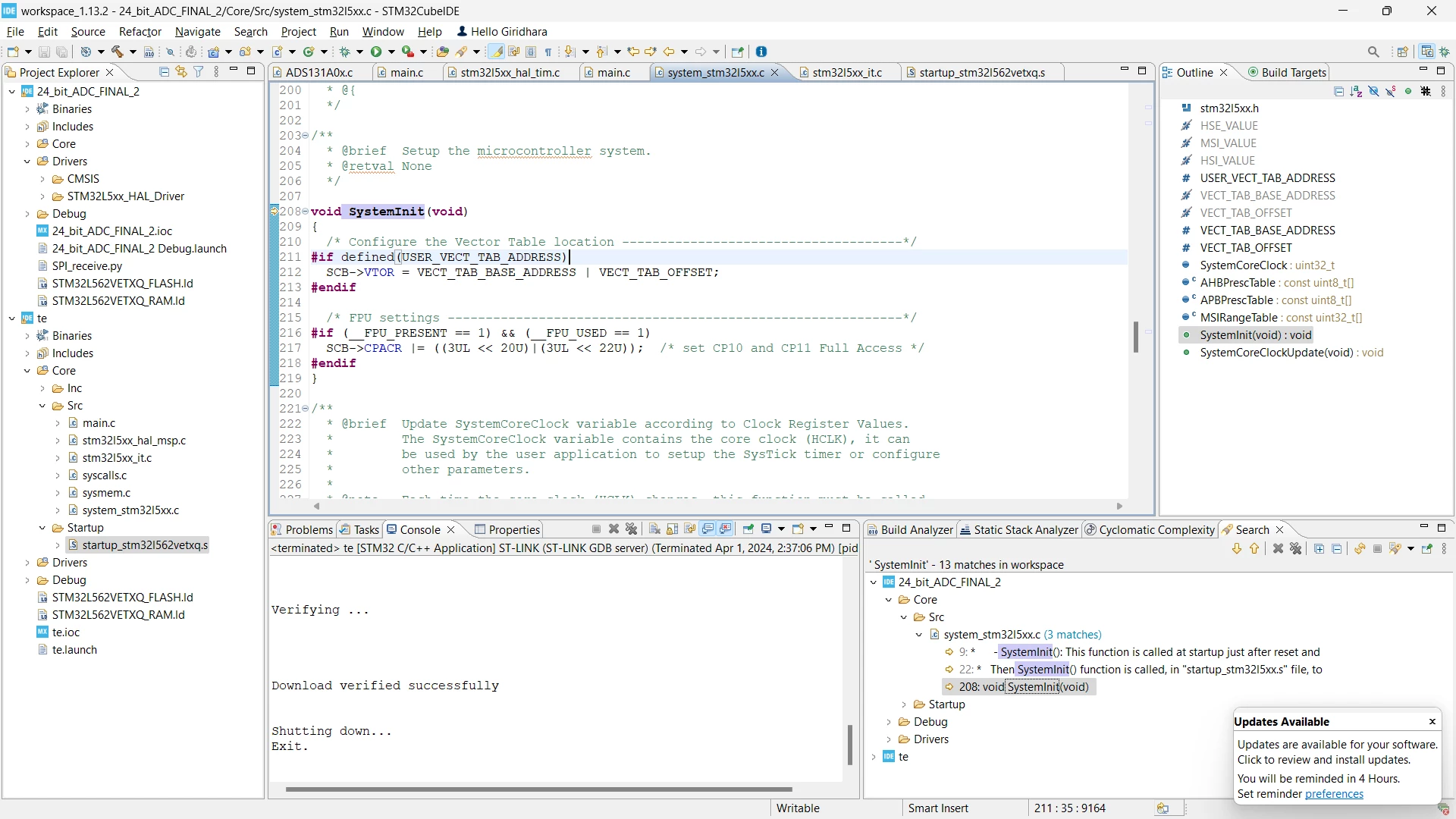

Here is the SCB->VTOR value:
Where
VECT_TAB_BASE_ADDRESS = (0x08000000UL)
and
VECT_TAB_OFFSET = 0x00000000U

No Sorry, I had not checked with the stm32cube programmer before.
Now I did, I compared the memory with the .elf file. It turns out the program is not getting erased but it is just not executing the program.
I'm just running the blink LED program to debug the error.
