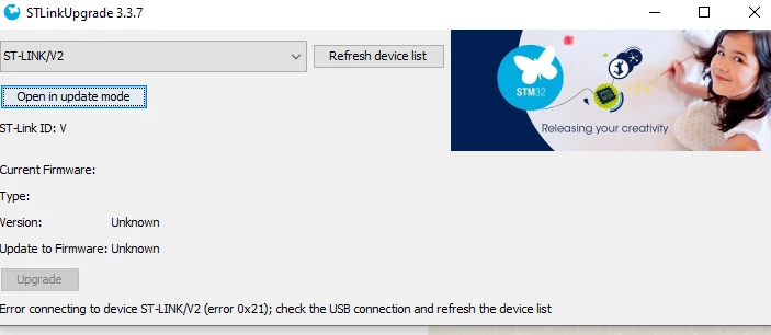

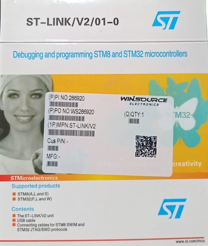

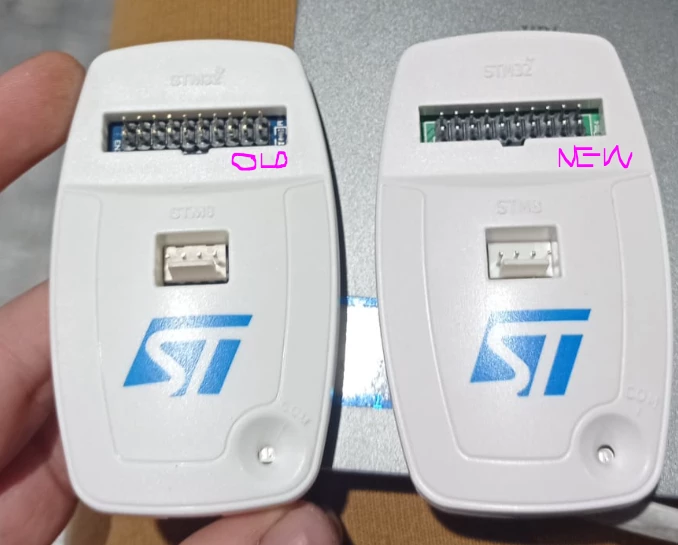

My company just purchased 10x new STLINKS in WINSOURCE.

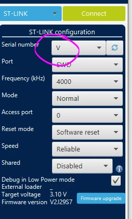

We are having trouble using them with newer versions of STCubeProgrammer(v.2.10.0)
,they work fine with the old STlinkUtility.
0693W00000WLQ5HQAX.pngI am also unable to upgrade the Fake STlink:

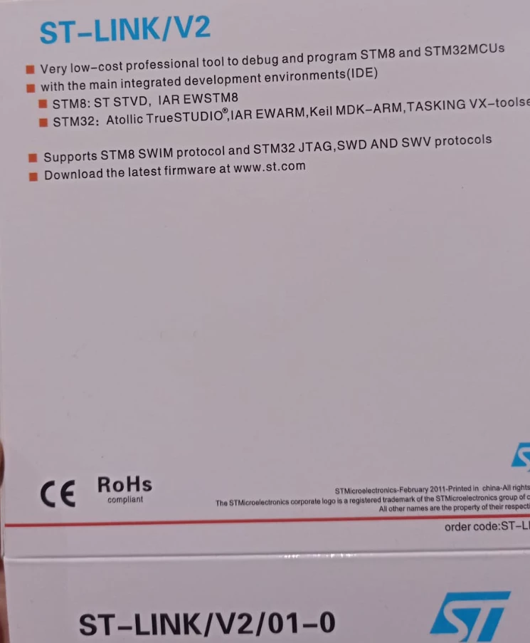

The BOX seems legit:

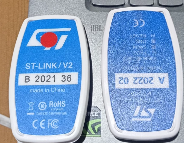

 The plastic molding looks alright also, the back sticker is upside down.

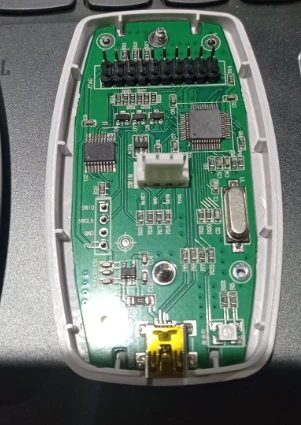

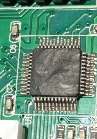

Once i open the new stlink, i notice the mcu markings are erased.
Best answer by Peter BENSCH
Everything you have analysed points to a counterfeit. The "ST" logo on the front is also stretched vertically. But at the latest in view of the abraded marking, it should be clear that this is a fake.
The only thing to do is to send the parts back to the seller and demand a genuine replacement or the money.

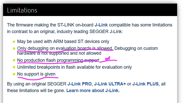

Hmm... Maybe, try this on it?
Javier1
Javier1Author
Principal
December 20, 2022
thanks @Pavel A.​ , lets try this.
I am not sure it will fix my issues, people in production use a lot the "automatic mode" from stmcubeprogrammer, this mode works slow/hangsup with the fake stlinks.
Edit:
I dont think im going to even try it, taking a look at the limitations:
hit me up in https://www.linkedin.com/in/javiermuñoz/
If the hieroglyphs on it is not a big enough sign of being fake, then I don't know that is. And also a Chinese company cannot be a legit distributor...
