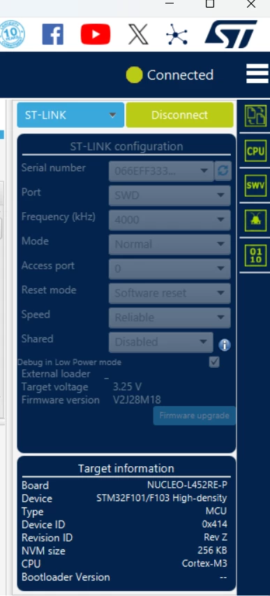

sonleducAuthor
Mar 22, 2026 6:16 AM UTC
It can be detected by stsw-link007-v3-17-10
Mar 22, 2026 12:38 PM UTC
> flash the firmware successfully using STM32CubeProgrammer, but debugging through STM32CubeIDE fails with the error above
Sounds like you are using a counterfeit programmer and/or board. This is typical behavior. A genuine board will work.

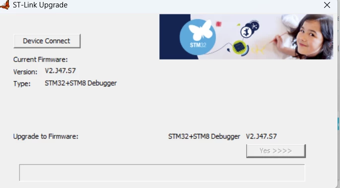

sonleducAuthor
Mar 22, 2026 3:11 PM UTC
Here is an issue as in the picture
