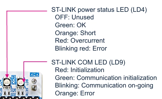

I'm a beginner programming a NUCLEO-N657X0-Q.
The LD5 is blinking and I can't get a connection to the board. Even with the demonstration code/project, it wouldn't work. In STM32CubeIDE I get the attached error message. As of yet, I never got to launch any program at all.

What are the status LEDs doing?
Can you connect with the standalone STM32CubeProgrammer? If not, post a full screenshot of the error message when it fails.

Hello TDK,
see the attached video.
Thank you for your help :)
