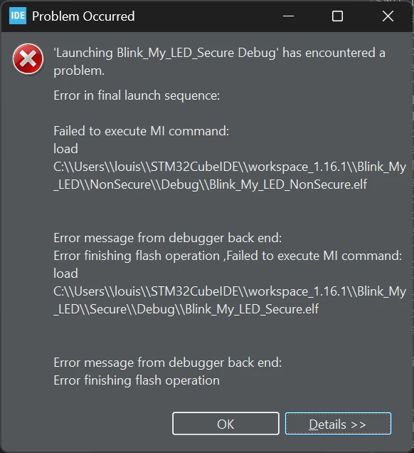

Hi evryone,
I'm trying to start a project with Trustzone activated, so I followed that tutorial by ST and I'm using exactly the same board the STM32L562E-DK but when I'm trying to flash the programm on the board I got that error:
And there is the log file:
STMicroelectronics ST-LINK GDB server. Version 7.9.0

Error: flash loader cannot be loaded.
Error: failed to download Segment[0]
Error: failed to download the File
Encountered Error when opening C:\ST\STM32CubeIDE_1.16.1\STM32CubeIDE\plugins\com.st.stm32cube.ide.mcu.externaltools.cubeprogrammer.win32_2.2.0.202409170845\tools\bin\STM32_Programmer_CLI.exe
Error in STM32CubeProgrammer

I have followed all the steps including the Cube Programmer configuration.
I also get the same error when trying to creat my own programm on an other board, the NUCLEO-L552ZE-Q.
All the same problems on the forum seems to occur with custom boards but it is not my case.
Can you help me please?

_Louis_Author
January 21, 2025
I downgraderd from CubeProgrammer v2.18.0 to v2.17.0 and I'm able to flash .hex files from CubeProgrammer but still impossible to flash from CubeIDE and perform debugging.
Do you have any leads?

Try reducing the swd interface frequency in debug configurations.
Visitor II
February 18, 2025
If you downgrade your CubeIDE version down to 15.1 you should be able to debug properly! I had the same issue and error with the same board and discovered that there's a bug with cubeIDE 16.1+ where it cant debug L562 boards. They recommend using openOCD as a debug probe, but I found downgrading to 15.1 also solves the issue.
Link to errata:
https://wiki.st.com/stm32mcu/wiki/STM32CubeIDE:STM32CubeIDE_errata_1.16.x#STM32L5
