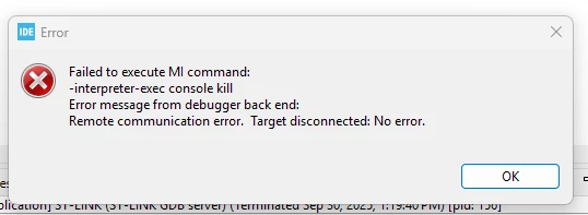

Hello together,
like many others here, I have the problem that after a short time, the debugger closes with the error message “Failed to get status,..”.
The board is the nucleo-F767ZI.
It has already been mentioned in the forum that it could be due to the USB cable. But the
same cable works with an nucleo-H755ZI-Q fine.
It was also written that it could be due to the settings or by the code self.

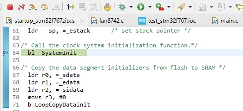

Therefore i did a test and sets a breakpoint direct after start:
When standing at the breakpoint, the debugger still terminates after a few seconds.

When I stop with the red button and try to start again, i got:
Then i  could load again.
As long as the debugger is stopped on line 64 “ bl SystemInit,” no code is running and the settings have not yet been made.
What could be the cause then?
