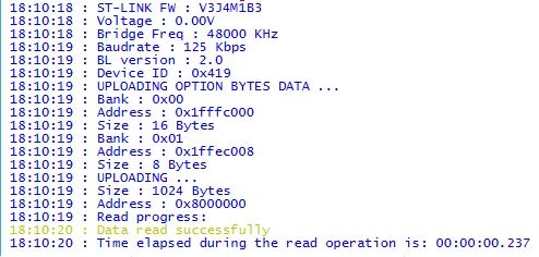

When I connect the PB5 pin (CAN_RX) and PB13 pin (CAN_TX) of the STM32F429 to the CAN_RX and CAN_TX of CN5 on STLINK-V3SET, the connection can be successful(as shown in figure 1).
0693W000000UyziQAC.png figure 1

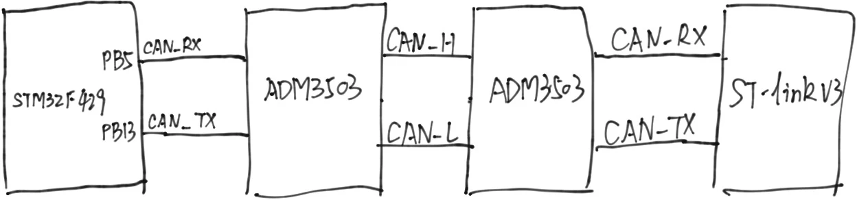

However, when I connected two CAN transceivers (ADM3503) between STM32F429 and STLINK-V3SET, in theory it should be able to connect successfully, but it actually failed to connect (prompt connection timeout).As shown in figure 2 is the connection diagram I drew,are there any errors? and why it can't work?
figure 2

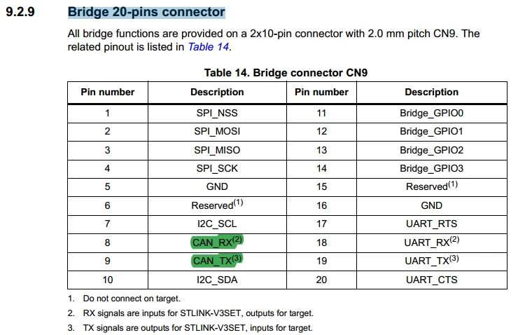

Then I found there have another interface to using CAN from UM2448(as shown in figure 3),but it still did not work,when I connected the outputs CAN_RX and CAN_TX of the ADM3503 to the CAN_TX and CAN_RX pins of CN9 on STlink-V3SET, respectively.
Another question is, I used a multimeter to measure that CAN_TX of CN5 and CN9 are connected, but CAN_RX is not connected. What is the reason?
figure 3

The CAN pins on CN5 do not require a CAN transceiver. If you look at the V3 manual you'll see that if CN5 is selected (with jumper JP7) then the signals on CN5 are T_CAN_TX (presumably this indicated transceiver CAN TX) and T_CAN_RX.
Using the CAN Tx and Rx on CN7 and CN9 both require the use of an external CAN receiver, whereas this is not the case on CN5.
Pjaco.1
October 7, 2021
whoops - I meant to say an external CAN transceiver, not receiver.
