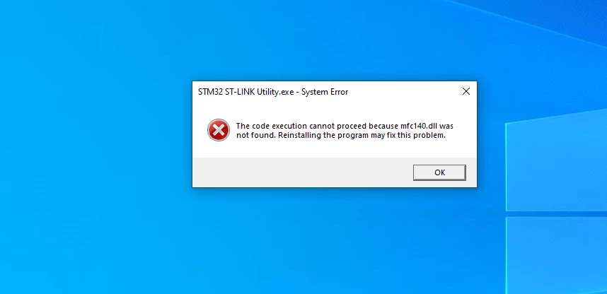

Facing a Problem with the ST-link utility Application
Hello every one!!!!
I am facing a problem when I am opening the ST-link utility
I have attached a file with screen shot please help me to solve the issue

Install Microsoft MSVC Redistributables. Often these aren't installed on new Windows versions.
Tesla DeLorean
Guru
May 18, 2022
Microsoft Visual C++ 2015 Redistributable Update 3 RC x86, on system complaining about MFC140
https://www.microsoft.com/en-us/download/details.aspx?id=52685
All-In-One Redistributable package
 https://www.techpowerup.com/download/visual-c-redistributable-runtime-package-all-in-one/

Thank you for your response!!
I have downloaded and installed the packages and I have successfully opened the ST-link utility its working now.
