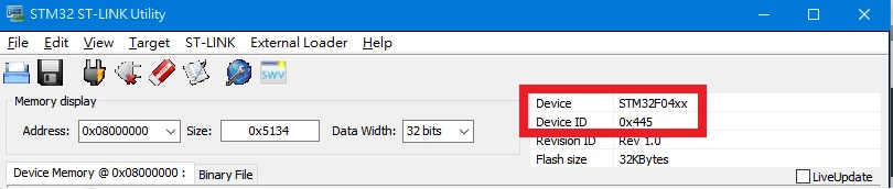

Hi, I am not sure if it's an proper question to ask here, but I ask it here anyway.
I've got some lovely tiny STM32F070F6P6 (with THIS package information on mcu) from china distributor.
Custom boards are made, chips are mounted.
When I start the ST-Link utility, it gives the following message:
Is this normal?
Or it's just a cloned F070, but with more functions like F04x?!
#stm32-f0 #st-link-utility #device-id

I should remark that this presumed F070 is currently running a USB CDC function without any problem.

I've just received my new
STM32F070F6P6 from MOUSER ...
Surprisingly the device ID is still 0x445 which means it's a F04x device.
I try to build some project for F040 and initialize some peripherals which don't exist in F030, (like I2S),
amazingly, it's working!!??
What can I do about this?
.Zt

ST has been know to ship parts with more advanced die than the marking would suggest. If the F04x is a super-set of the F070 then that is a possibility.

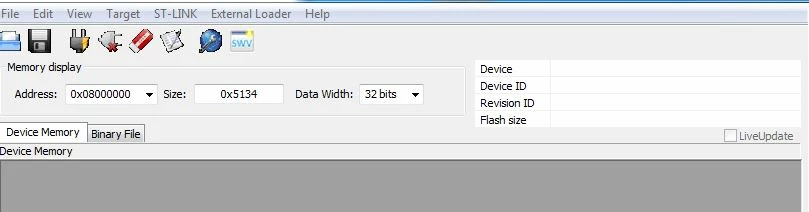

0690X000006D4BFQA0.jpgI have problem with STM32 loader as the picture : There is no device number and device ID !
