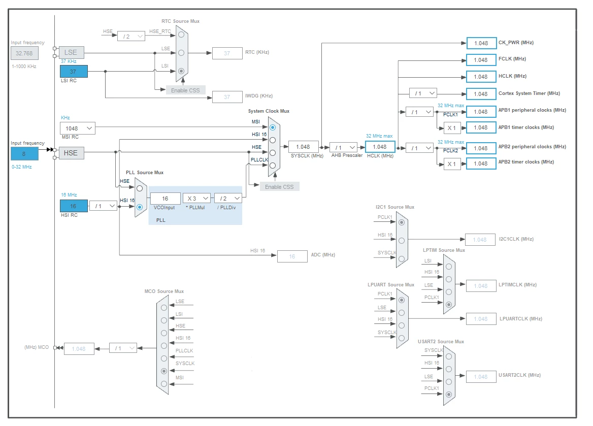

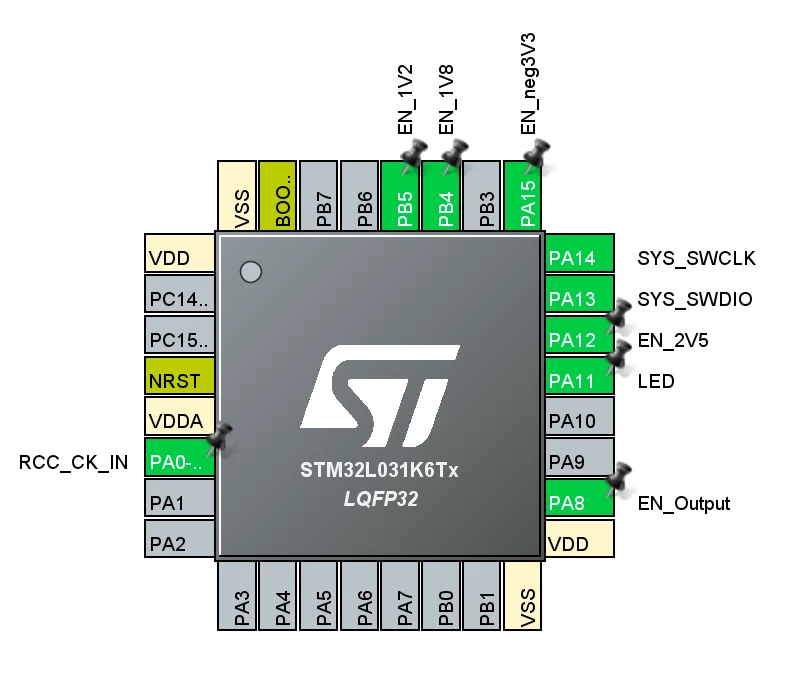

I've attached screenshots of my CubeMX setup incase I've made an obvious mistake that's causing these issues.

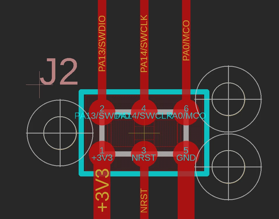

The TagConnect 2030 header connects the STlink to the board's VDD and GND, which shouldn't be a problem and the remaining pins are connected to the L0's nReset, SWCLK, SWDIO and RCC_CK_IN, I've attached a picture of the footprint.

>> and use an ST-Link/V2 with a TagConnect-2030-IDC
I see there is a PA0/MCO(RCC_CK_IN) Pin on your TAG connect implementation... But ST-Link V2 doesn't supply MCO.
So what do you connect to that pad ?

Alec1
Alec1Author
May 18, 2022
I'd connected that to the High speed clock input pin on the L0 thinking the ST-Link would be able to provide a master clock when using software debugging. I've been using VisualStudio Code for writing and compiling my code and have been able to use its debugging tool with the Nucleo boards, so assumed this was how to implement it but you're right this is wrong. I will try cutting the trace and seeing how things go.
