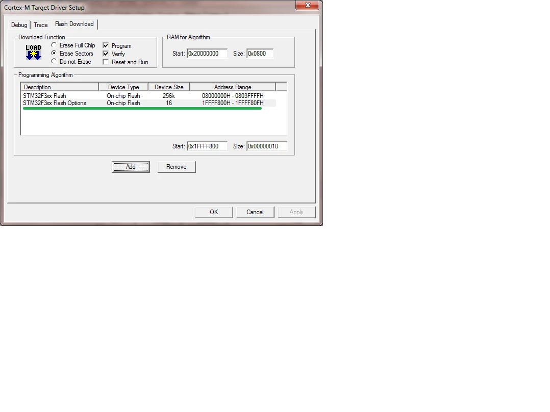

Well the ST-LINK isn't really what I'd call a commercial solution, the Segger guys have a lot of practical and learned knowledge about this stuff.
I'd pay attention to what the NRST pin is doing, and what you have going on in your firmware early in the boot/reset sequence. Wrestling a processor to a stop initially is a key part of the task.
It is also not necessary to rely on SWD/JTAG tools to program option bytes, these are things you can initialize or change from within your own application code, or boot loader.
Keil allows you to select a programming algorithm for the debugger which is agnostic to which pod you are using.
