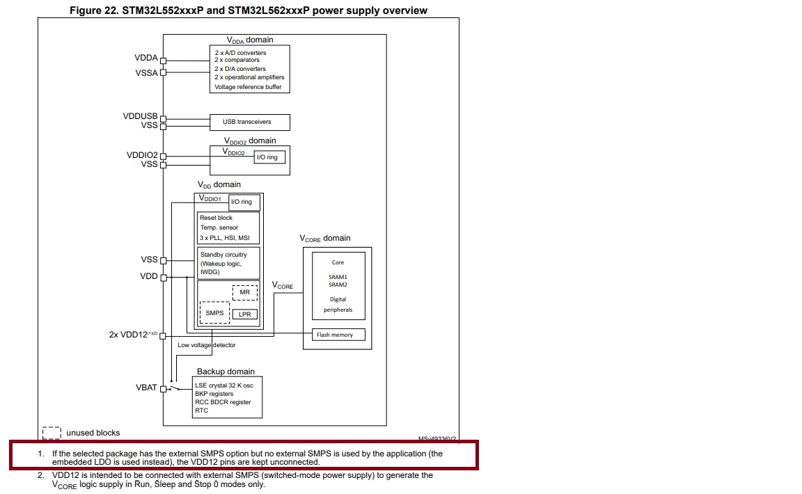

I have to use STM32L562CEU6P on my project.
This uP has two VDD12 pin for external SMPS.
My question is simple, this SMPS supply is required or can I left this pins floating?
I don't need this feature and manual is not very clear.
Thanks in advance.

Hello @MFail.1​ ,
Welcome to STM32 Community!
Please refer to RM0438 (Section 8 Power control (PWR))
0693W00000BZz0LQAT.pngif an external SMPS is used, these pins must be connected.
otherwise (i.e. LDO is used for Vcore) these pins can be NC.
Imen

Thank you so much, I have not seen this note at my first look.
