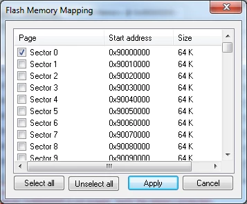

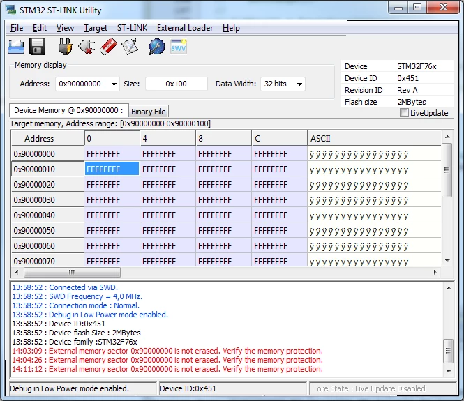

When I try to erase a sector ST-Link reports an error:
External memory sector 0x90010000 is not erased. Verify the memory protection.
However after refreshing the content view, I can see that the sector was erased properly. I have also observed that the callback function Erase() terminates properly. I am using the LEDs as feedback.
After erase Verify() was not called so I thought that ST-Link reads the memory back. I had no luck with disabling and re-enabling the memory mapped mode of the QSPI within the Erase() function.

So far I have seen, that Write() works perfectly on a total erased flash. SectorErase() however does always result in the fault stated above, even though it returns 1 and indeed erases the specified sector.
Using a normal test application SectorErase() works as specified.
The fault message occurs also if the sector is already erased, and the function SectorErase() does not contain any code except 'return 1'
Can some one tell me, what the ST-Link utility does additionally than executing SectorErase(). Are there any other prerequisites I do not fulfil here?

Well, the problem is not the communication with the QSPI. That works perfectly. Also the command SectorErase() is executed properly. My question relies what the ST-Link-Utility wants after executing SectorErase().
After deleting a single sector, ST-Link-Utility even shows me all the contents of the flash properly.
The code in question does not contain any magic.
KeepInCompilation int SectorErase (uint32_t EraseStartAddress, uint32_t EraseEndAddress)
while (EraseEndAddress>=EraseStartAddress)
uint32_t BlockAddr = EraseStartAddress & 0x0FFFFFFF;
uint8_t ret = BSP_QSPI_Erase_Block(BlockAddr);
EraseStartAddress += 0x10000;
return 1;
I mean, it executes and terminates perfectly. What I wonder is, what happens afterwards that makes ST-Link-Utility report this error and refuses therefor to erase and program the QSPI flash in one step.

Hi Daniel,
I found the same problem but it has been solved by calling
SystemInit ( see in system_stm32f7xxx.c ) on Init
int Init( void )
__disable_irq( );
SystemInit( );
I don't know why N25Q256A_STM32L476G-EVAL_Cube works without SystemInit.
May this help you too.
