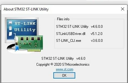

Hello @User16438042334827474767​ and welcome to the STM32 Community,
Which version are you using ?
Could you try STM32Cubeprogrammer software. Then, please let me know if this solved your issue.
Imen
April 1, 2021
1)I used the version attached, please check
2) I also tried the cube programmer v2.4.0 , but I got the same result but new things happened. First mass erases work well and again when I do the same the mass erase fails. My log is given below.
