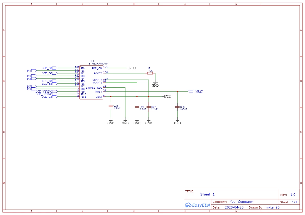

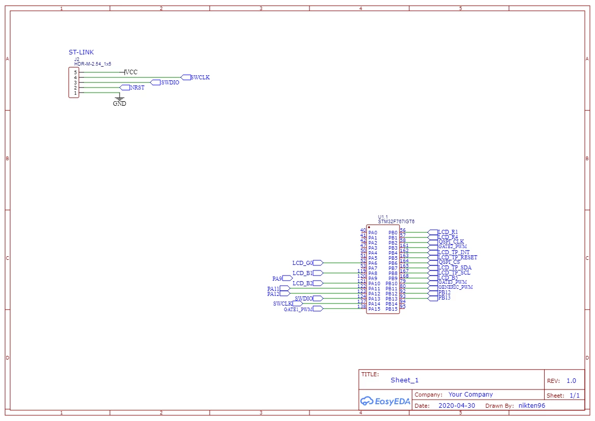

i created a custom board which foundamental schematic is like the images:
I'm using the classic ST-LINK USB Debugger but i can't debut nor upload my code inside my STM32F767IGT MCU, both with STM32CubeIDE and STM32 ST-Link UTILITY.

Typically each should be individually wired to own capacitor. Expect 1.2V on these pins
Definitely not connected to VCC
3 replies
May 28, 2020 7:26 PM UTC
VCAP_1 and VCAP_2 should not be connected to VCC. Even if you fix this, the chip may be dead since the voltage on those pins is normally around 1.2V.
Tesla DeLorean
Tesla DeLoreanBest answer
Guru
May 28, 2020 7:31 PM UTC

Perfect, it works now! Thank you!
