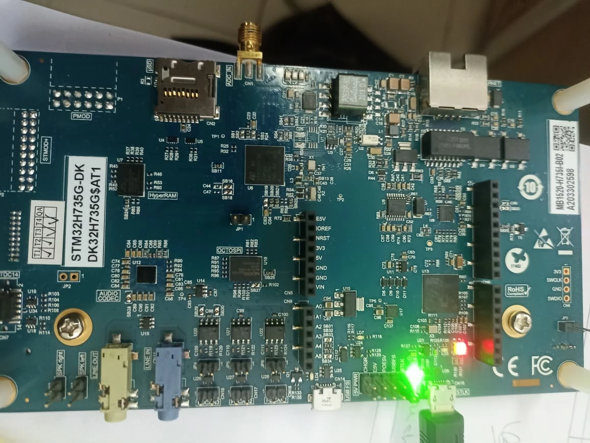

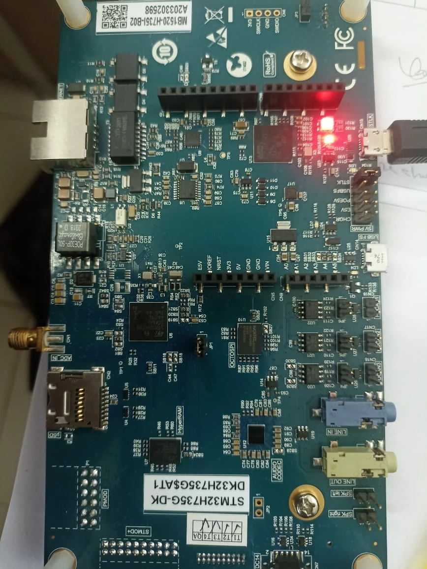

Dharmesh
DharmeshAuthor
Dec 19, 2022 11:07 AM UTC
thank you for prompt reply.
  1. current jumber is connected. and i have checked current consuption by removing JP1 and keep multimeter across it is 60 miliamp. i have connected board using ST link.0693W00000WLJGNQA5.jpg0693W00000WLJGDQA5.jpg

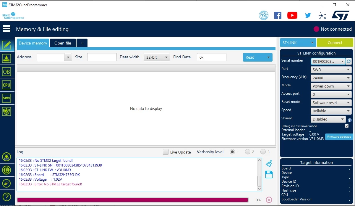

Dharmesh
DharmeshAuthor
Jan 3, 2023 10:42 AM UTC
Hi..
I followed to connect board under power down mode but still getting same issue No STM32 target found!.
Dharmesh
DharmeshAuthor
Jan 3, 2023 10:56 AM UTC
And one more LED LD3 continue ON..
This LED is for STLINK-V3E Over Current.
