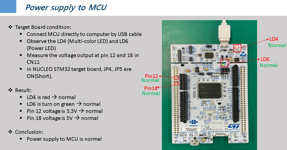

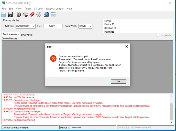

I am using the STM32 Nucleo-144 evaluation board and trying to upload the program by the STM32 ST-LINK Utility.
When I try to connect to the board, the console always shows the following error message: "No target connected," "Can not connect to target!"
At the same time, an Error occurred in initializing the ST-LINK device.
Reason: USB communication error. Please reconnect the ST-LINK USB cable and try again.
I changed the USB cable, but the phenomenon is the same.

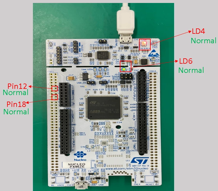

And also checked the VDD power on the board, and all of the digital power is in normal operation.
What can I check more to solve the reasons for this issue?

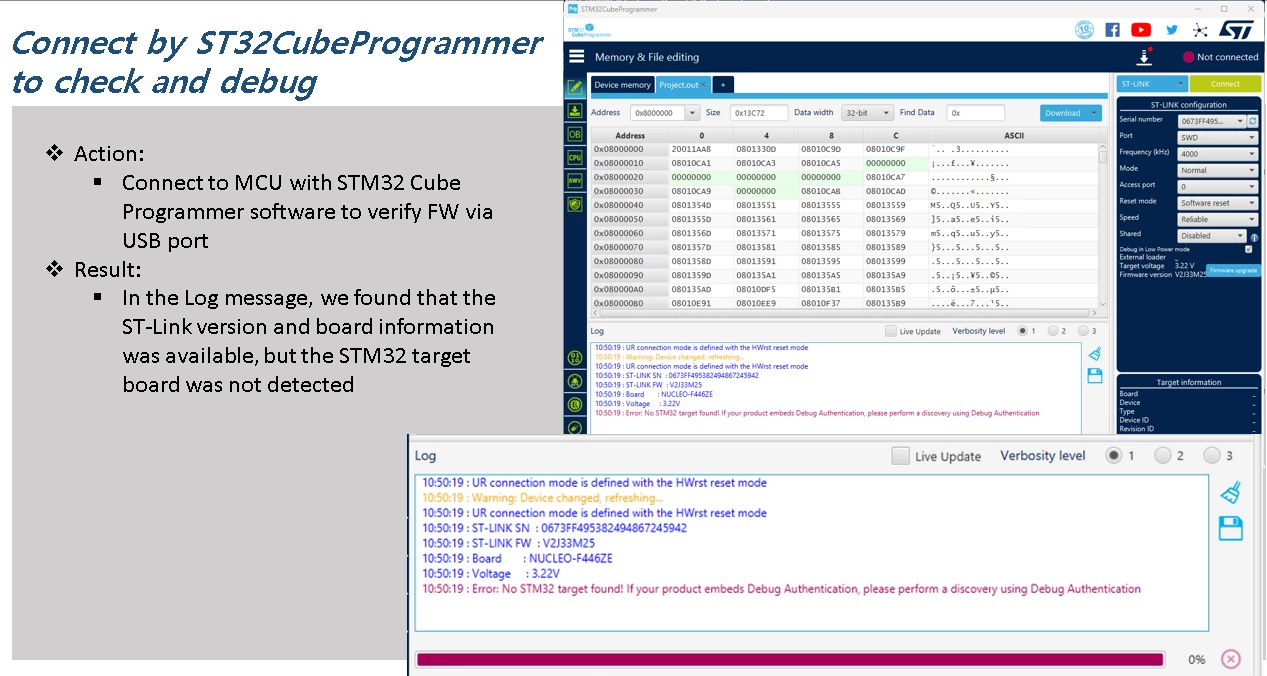

Do you have the same issue when your STM32 board is powered by default (JP5 On)?
Please, try to use the STM32 Cube Programmer.

@KDJEM.1​ And we tried to connect to MCU with STM32 Cube Programmer to verify FW via USB port. In the Log message, we found that the ST-Link version and board information was available, but the STM32 target board was not detected. In the results, the disconnection to the target board issue was the same.

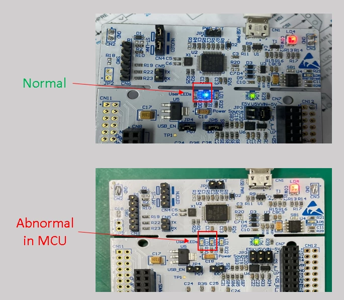

3. Isn't any possibility that this issue occurred by bootloader failure in the STM32 target board?

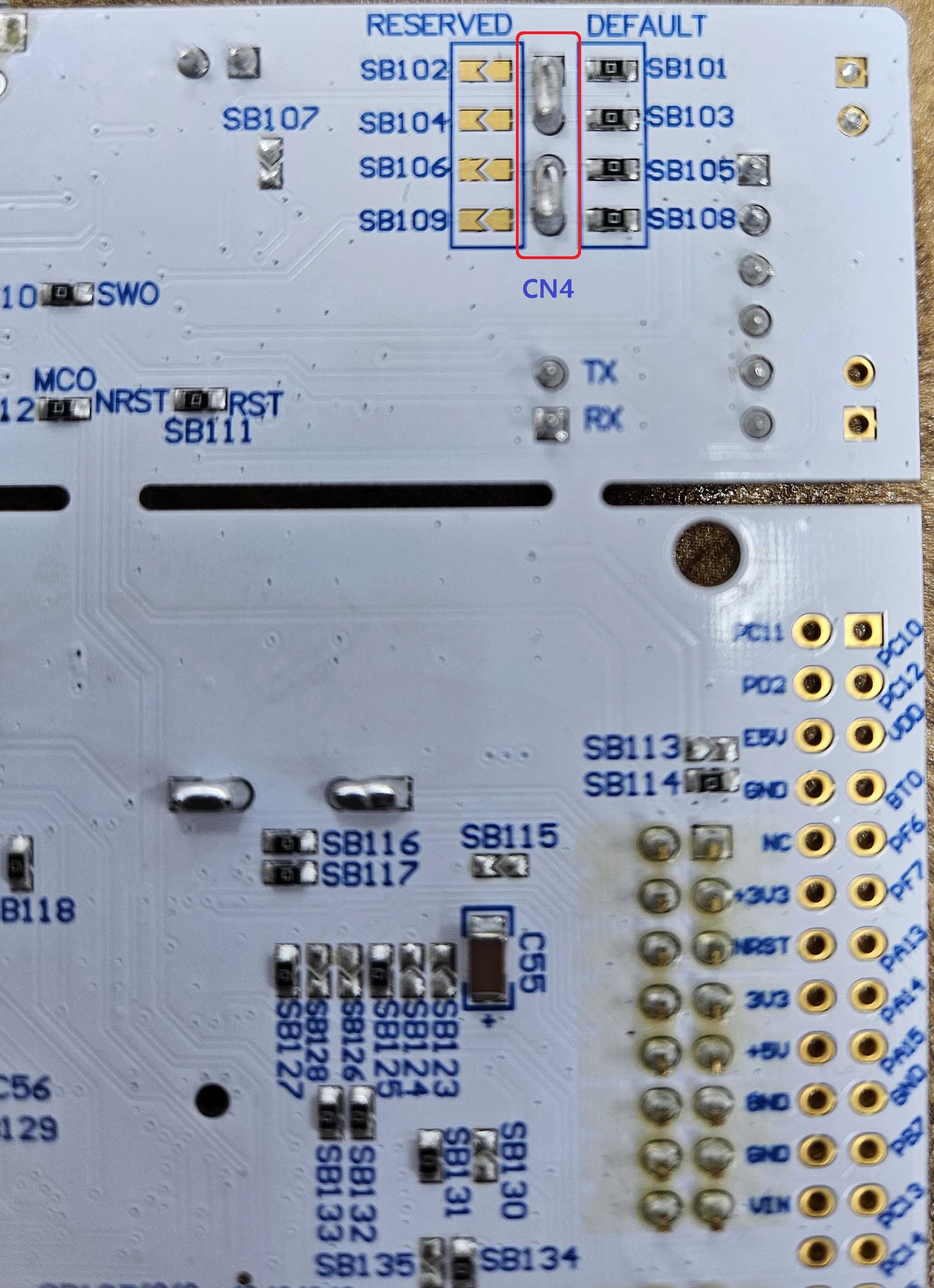

Put the jumpers back on CN4​
Jonathan Kim
April 19, 2023
We have shorted the CN 4 from the backside of the board.
I think that It is the same as putting on the jumpers of the CN4​.
