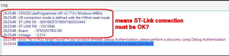

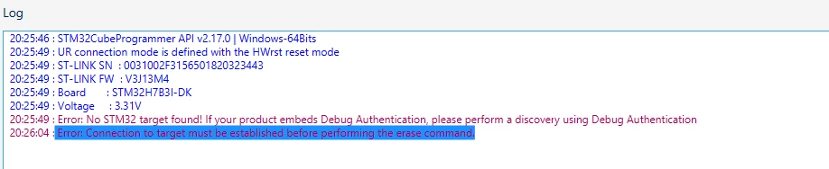

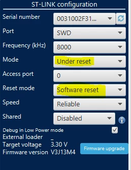

I have an issue on STM32H7B3I-DK, I am not able to flash code, I atleast want to perform full erase, but I am getting " Error: Connection to target must be established before performing the erase command." error.
Fig: STM32CubeProgrammer.
Fig: Trying to erase the board. But still getting the above error.
Anything else can I do on this board.

Andrew Neil
September 3, 2024

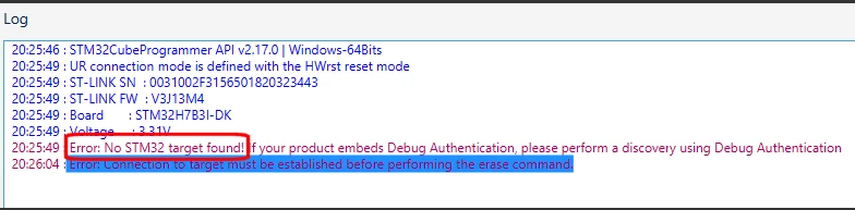

It's telling you that it can't connect to the Target; therefore it won't be able to do anything to the Target until that is fixed!

Andrew Neil
September 3, 2024
@mƎALLEm wrote:
Are you sure you are using a data cable and not a charging cable?
It seems to be indicating that the connection to the ST-Link is OK:
So the cable must be good?
