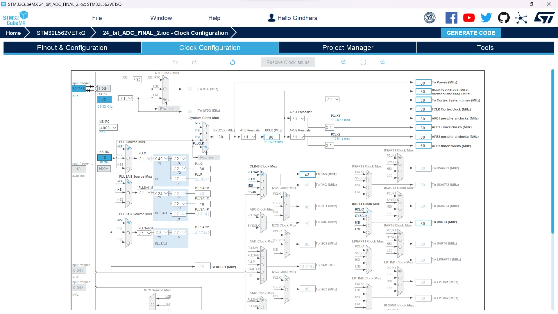

I'm writing to report a critical issue affecting the SPI sampling rate when using the USB device middleware/software package as a Communication device class on an STM32 microcontroller.
Detailed Scenario:
I'm employing Timer TIM15 configured for a sampling frequency of 10 kHz (10,000 samples per second) to acquire data from a sensor connected via the SPI1 peripheral.
The SPI1 clock frequency is confirmed to be at the expected 20 MHz (main clock of 80 MHz divided by a prescaler of 4).
When the USB device middleware is disabled, the sampling functions as intended. A video attachment (Video 1) demonstrates the Index variable reaching values from 0 to 40,000 within 4 seconds, aligning with the 10 kHz target rate.
Crucial Observation:
Timer Clock Reduction: The core problem lies in the timer clock being halved when the USB middleware is enabled. This was verified by toggling a GPIO pin within the timer count elapse callback, which confirms a sampling rate of only 5 kHz instead of 10 kHz.
Unexpected Behavior:
With this reduced timer clock, the MCU theoretically requires 8 seconds to collect 40,000 samples (40,000 samples / 5,000 samples/second). However, in reality, the sampling process takes significantly longer, exceeding 2 minutes.

Set the USB interrupt main priority to one of lower levels, like 12..14. Set the timer priority to high level - 0 is the highest. Leave priority grouping at the default value (16 main levels, no subpriority).
