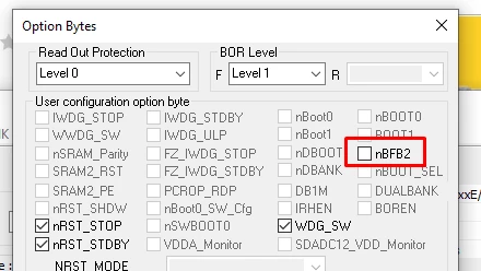

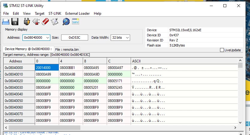

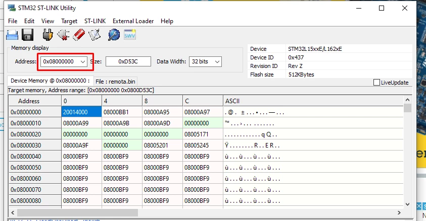

i am not able to run any code on bank2 with STM32L151RE with 512kB FLASH.
program was loaded on both regions 0x0800 0000 and 0x8004 0000
0693W00000HniqRQAR.png0693W00000HniqvQAB.png0693W00000HnirFQAR.pngif nBFB2 is checked the code runs ok, if i just unched the code does not run....
what am i doing wrong?

Hey Dfont,

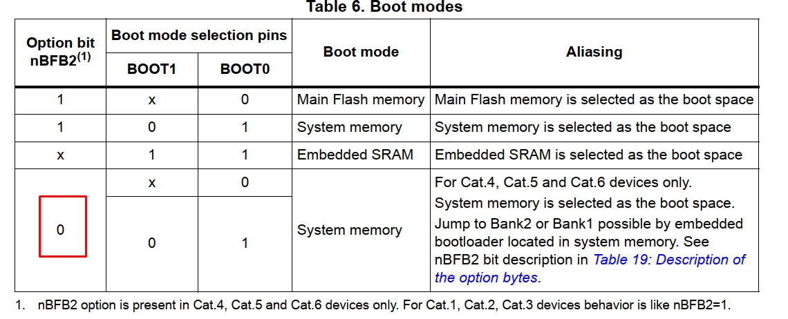

If nBFB2 is checked, the system boot mode is selected using the BOOT0 and BOOT1 pins on your device. What is the signal level on these pins?
Are you able to debug at all when nBFB2 is unchecked?

BOOT0 is at GND, BOOT1 (PB2) is floating...
i am using a nucleo64 board MB1136, i replaced the original STM32L152RE with a STM32L151RE to ***** the dual boot, as i have verified the 152 does not have dual boot mode, is that right? or both of them work in dual boot mode?
but as i can see, if nBFB2 = 0 (unchecked), i.e. dual boot mode is active, the pins BOOT1 and BOOT0 does not matter, on booth cases the boot will be from "system memory", jumping to bank2 or bank1

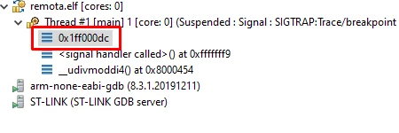

i am not able to debug when nBFB2 is unchecked
it seems to be locked in some region of the system memory
diegofontanabr
December 7, 2021
if i debug step-by-step (instruction by instruction) i can go very far away, but if i use the "step over" the process halt to that address

in the aplication note AN2606 it says "If Value @0x08040000 is within int. SRAM address" > "Jump to user code in Bank2", the value 0x20014000 is a valid one?

in AN2606, page 307 Figure 73. Bootloader selection for STM32L1xxxE devices, where it says "BFB2 = 0", its the same as "nBFB2 = checked" (it has a "n" in front) in the option bytes of the STM32 ST-LINK Utility?

Wow, lots of questions there. I have had many years of experience as well and this Dual boot design is not very good. From what I have found so far, you set the BFB2 bit to force the internal ST bootloader to use Bank2, but there has to be a valid vector at the first address, if there is not the PEMPTY bit gets set which is causing all sorts of issues for me. As for compilation, no the same exact image can run in both banks, the ST bootloader should branch to the correct bank based on the BFB2 bit.
