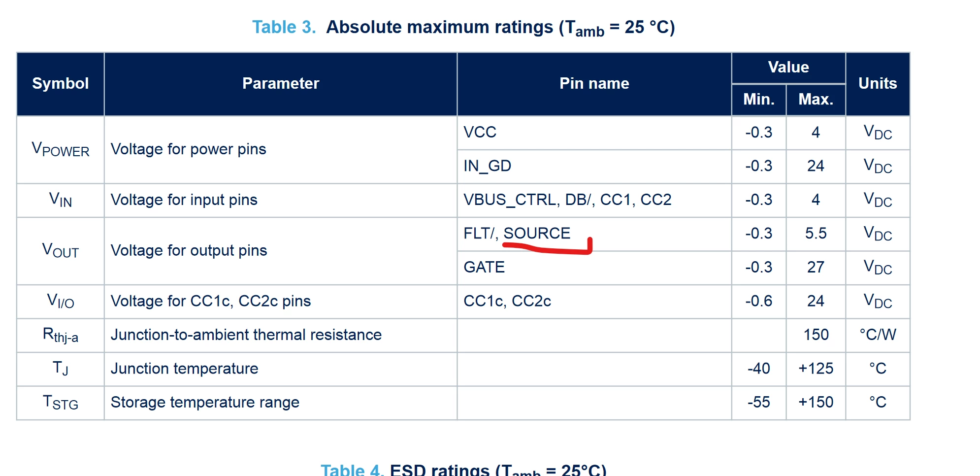

Does TCPP01-M12 Source Pin (pin 4) really have a 5.5V Absolute Max voltage limit?
Table 3 of DS12900 - Rev 6 shows a max voltage of 5.5V, which doesn't make sense, unless I'm missing something very important.
Is this just a typo? Seems like it should be on the same line as the GATE pin or IN_GD.
Thanks

Hello @bdieh.1​ and welcome to the Community :)
Thanks for pointing out this issue.
I confirm, it is a typo: SOURCE PIN ARM is 24V. As you write it is the same value as IN_GD.
An internal ticket ID 145127 is submitted in order to update the Datasheet.
(PS: ID 145127, this is an internal tracking number for reference and is not accessible or usable by customers).
