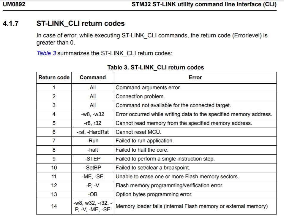

Do STM32CubeProgrammer Command Line interface have return codes?
0693W00000Dlb59QAB.pngSince STM32 STLINK Utility Command Line Interface has return codes, why STM32Cube Programmer don't have?

Guillaume K
Aug 30, 2021 12:40 PM UTC
it seems that STM32CubeProgrammer returns 0 (zero) if no problem and a code different from zero in case of error. But it is not documented in the user manual as ST-LINK Utility.
Example of error case: On a Windows PC, if no STM32 connected to the PC:
STM32_Programmer_CLI.exe -c port=swd --list
 STM32CubeProgrammer v2.8.0
Error: No debug probe detected.
c:\>echo %ERRORLEVEL%
1

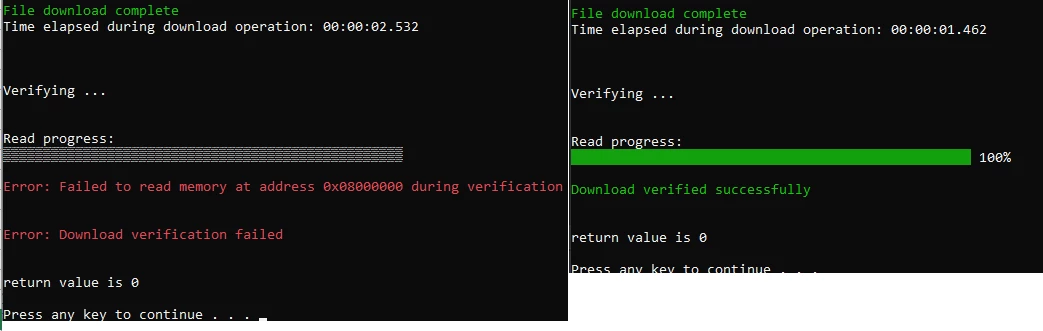

FArdi.1
Sep 28, 2021 7:22 AM UTC
0693W00000FAbGLQA1.pngHopefully can be fixed soon. My product's manufacturing process depends on returned-code to detect failure in programming.
Now always return zero in any condition: STM32CubeProgrammer (2.8.0)

DLang.4
Mar 20, 2023 9:10 AM UTC
Is this issue solved? Its a problem in our production too

Feb 14, 2025 8:23 AM UTC
Hi to all
I know this is a old theread but are there any news about the return values from STM32CubProg CLI.
I observed that is retuning 0 for now error and if there is an error 1. Is there still no list of error codes to get the exact failure?
