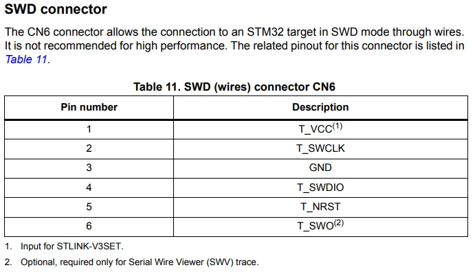

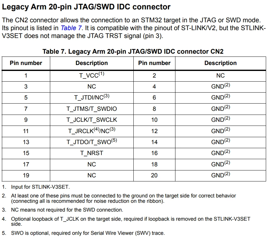

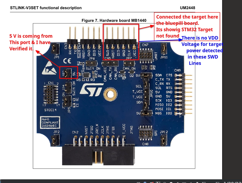

I have a STLINK-V3SET and I'm trying to comunicate with a STM32F103C8T6 (Blue Pill). I'm sucessful only when the board is externally powered by it's USB port. The STLINK-V3SET SWD or JTAG connectors have a T_VCC pin, which I now realized are an input
The connectors' description in the user manual:

> 1) Do STLINK-V3SET really DON'T have a 3,3V power output?
Correct. They do not have a power output. This follows the standard established by ARM, and is common for programmers.
As programs are typically not always run with a debugger attached, this is often not a problem. Power the board how it would be done in the final application.
Perhaps look into a nucleo board rather than a blue pill, as the former will have normal SWD debugging and (bonus) a genuine chip that works and an on-board debugger.

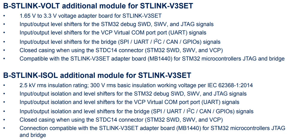

And neither the B-STLINK-VOLT additional module for STLINK-V3SET nor the B-STLINK-ISOL additional module for STLINK-V3SET would be able to supply the circuit with the 3V3, right?
August 22, 2024
No. Power doesn't appear on any standard debug headers.
If you are making your own programmer, I'm sure you can find a 3.3V rail on the actual board to tie into. But again, probably better options here (e.g. Nucleo board).

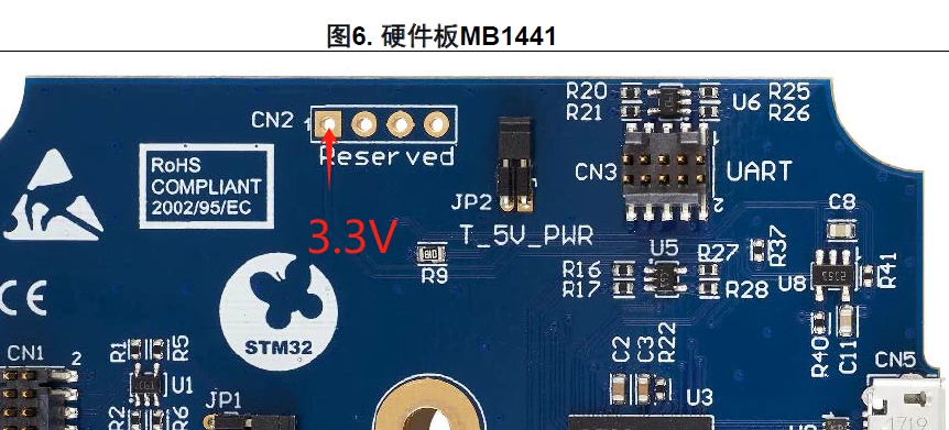

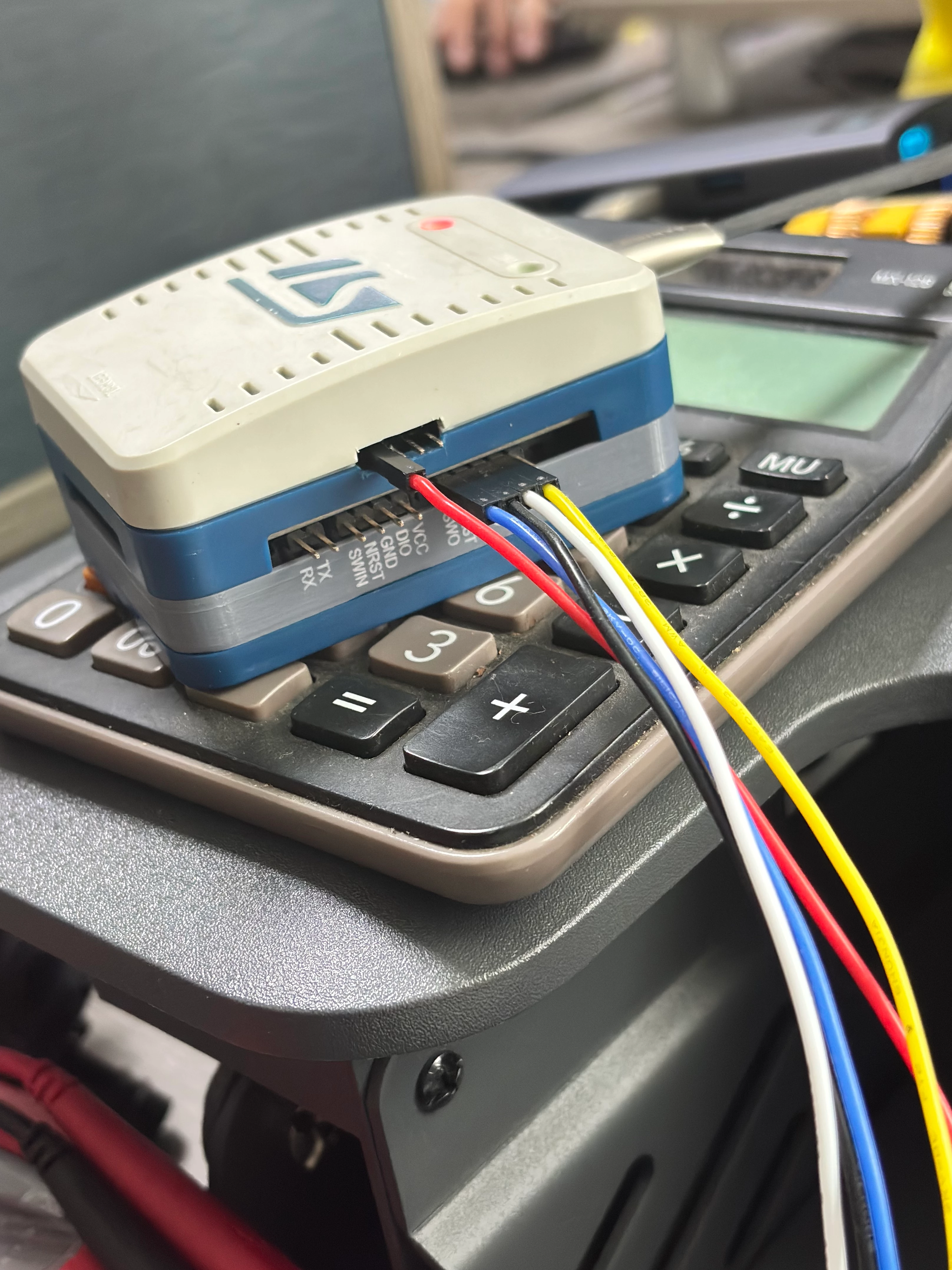

Visitor II
March 10, 2025
Hey Roitav,
I just connected the power of 3.3V in the V3set and using it, then I found you have the same trouble on this,
so I am happy to let you know how to get it, see the pictures in below :
