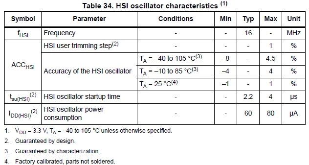

Do I need an crystal Oscillator?

The external crystal is needed only for USB, or when some timing task requires better accuracy than HSI.
E.g. as an asynchronous UART requires 5% accuracy, it might not work reliably in extreme temperatures.

Check the electrical characteristics chapter in the reference manual, both for ADC and the HSI internal oscillator. If they are adequate for your need, then no external components are needed apart from the decoupling capacitors.
Also read AN2834 How to get the best ADC accuracy in STM32 microcontrollers

The internal frequency HSI has some tolerances across chips, temperature etc... you will get a min-max range from this.
Now check if all your peripherals are ok with this.
Using USB? Need probably HSE
Using high speed UART? Need probably HSE
Using RTC? Need probably 32.768kHz HSI

so if I need UART, then I should add a 8MHz crystal oscillator, right?
berendi
Principal
January 25, 2020
Only if it would be used in a freezer, oven, or outdoors (i.e. outside the -10...85 °C range), and the usart speed is above 500 kbaud.
