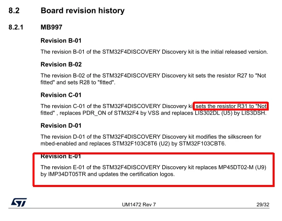

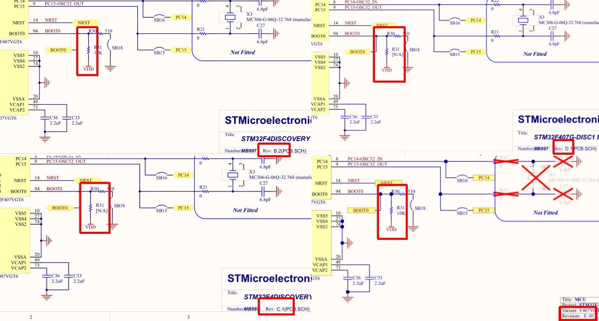

Schematics say, it is populated on Rev.B and Rev.E,  but not populated on Rev.C and Rev.D:
If it is populated on Rev.E, UM1472 fails to mention that in the revisions changelog:
And in any case, absence of R31 in Revs. C and D should be mentioned in conjunction with SB18 in Table 6. Solder bridges.
