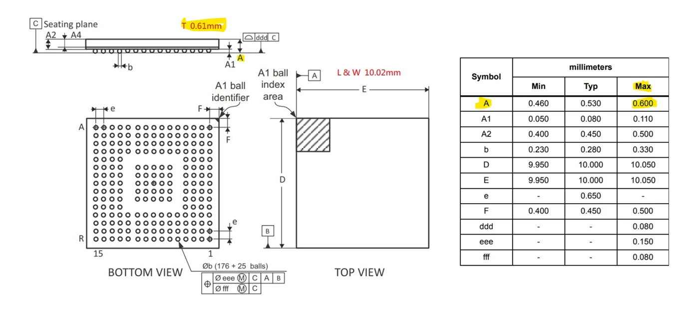

Cchen.1
Cchen.1Author
May 5, 2023
Thanks Kaouthar, According to table 120, The maximum thickness of A should be 0.6mm while we measured several pieces all excess 0.6mm. is that normal?

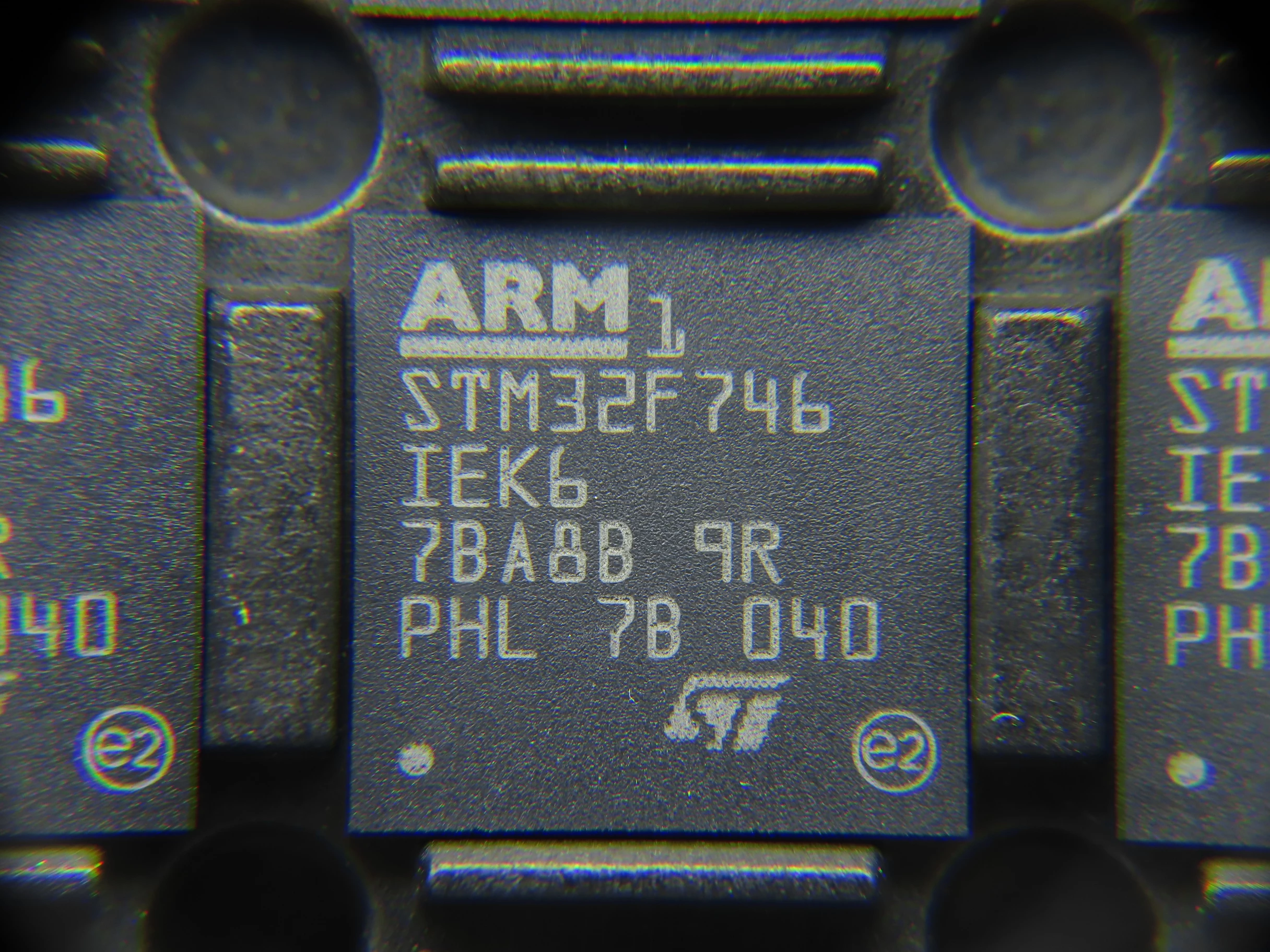

KDJEM.1
May 5, 2023
Hi @Cchen.1​ ,
The A value should be between 0.460mm and 0.600mm.
To check this issue, can you please share the chip photo of your STM32F746IEK6 MCU.
Kaouthar
Cchen.1
Cchen.1Author
May 5, 2023
hi Kaouthar
here's the picture. btw just curious A1 is 0.05-0.11 , A2 is 0.4-0.5 ,A = A1+A2 , then A=(0.05+0.4-0.11+0.5)=0.45 -0.61 which is against 0.46mm-0.6mm,
