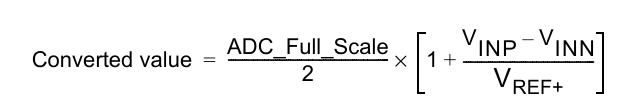

We are now able to read the sine wave using the ADC. The input is converted from single-ended to differential before being fed to the ADC. However, we are observing that the amplitude is limited to 500 mV.
We are applying a 1 V peak-to-peak input signal, but the ADC is only capturing 500 mV peak-to-peak at its input.
Could you please check this issue?
We have attached the ADC output and amplifier configuration for your reference.
Best regards,
Samudralankaiah.
Jun 14, 2025 12:11 PM UTC
With VREF+ = 2.5V, differential voltage is (VREF+) * 2 * (counts - 32768) / 65535. You are missing this factor of 2 in your calculations.
