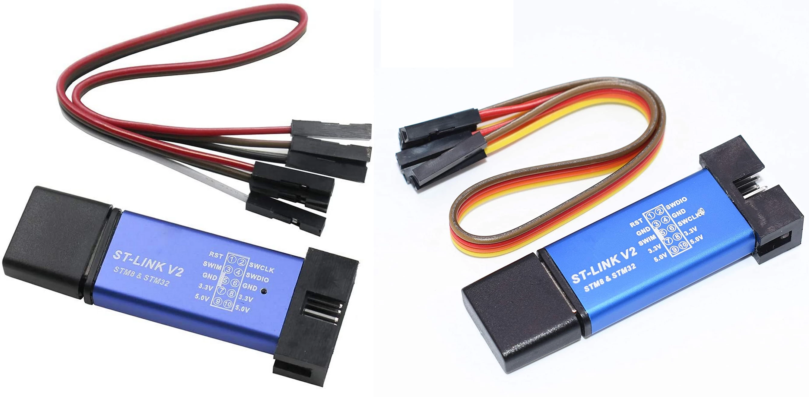

Are these authentic or clones?
Watch that you're powering pins 1 or 2 with VTarget so as to power the buffers.
Andrew Neil
Feb 11, 2021 12:39 AM UTC
"Are these authentic or clones?"
+1

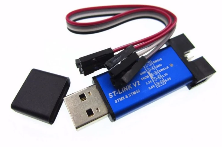

If you've got cheap clones like this from ebay or the like:
0693W000007EoJJQA0.pngbeware that there are at least two different pinouts on otherwise identical-looking products!
EDIT
Here you go:
0693W000007EoKCQA0.pngClick the image to enlarge - Look carefully at the two pinouts!
