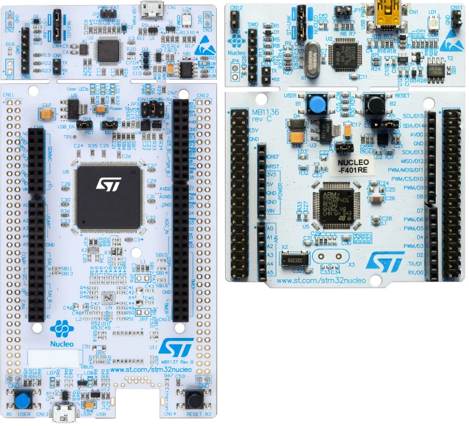

Hello... can anyone advise on the difference between F446RE and F446ZE? i just found out the USART to USB VCP was shifted to USART3 instead of USART2 in the new ZE. Can anyone advise on any other difference?

You could look at the two User Manuals:
F446RE: UM1724, STM32 Nucleo-64 boards (MB1136)
via: https://www.st.com/en/evaluation-tools/nucleo-f446re.html#documentation
F446ZE: UM1974, STM32 Nucleo-144 boards (MB1137)
via: https://www.st.com/en/evaluation-tools/nucleo-f446ze.html#documentation
Also the schematics - see the 'CAD Resources' tabs on those Product Pages.

Well apart from them being entirely different boards, with different pin counts, and escape to different headers, etc
Same IC / DIE, so 180 MHz, 512 KB Flash, 128 KB RAM
QSPI Escaped
Indeed:

It's my view that you'd need to do a complete reappraisal of the pin usage, and look at all the stubs and escape paths to the different header arrangement.
It doesn't implement the Ethernet of the other NUCLEO-144's for parts that do, and I'd expect the Arduino shield connections to be going to different pins also.
One of the big issues with the NUCLEO-64 designs is that the Arduino shield D0/D1 clashed/share a UART resource with the VCP, and this gets avoided with more pins and UART escaped.
The double wide Arduino connector is a challenge, not seen a breakout / protoboard
You need different X-NUCLEO-GFX shields for NUCLEO-64 vs 144
https://www.st.com/en/evaluation-tools/x-nucleo-gfx01m1.html
https://www.st.com/en/evaluation-tools/x-nucleo-gfx01m2.html

>>I just found out the USART to USB VCP was shifted to USART3 instead of USART2
This is somewhat of a blessing, as now the F4 has a different UART for the Arduino D0/D1 pins from that of the VCP, so you can now use BOTH
