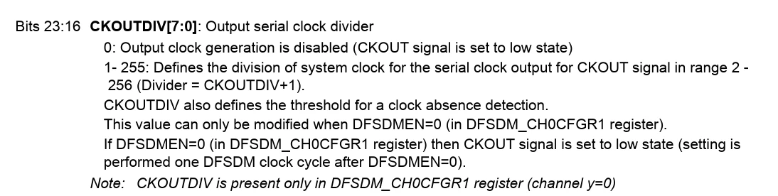

from rm :
So set ..try:
hdfsdm1_channel2.Instance->CHCFGR1 &= 0x7FFFFFFF ; // dfs off
hdfsdm1_channel2.Instance->CHCFGR1 = (hdfsdm1_channel2.Instance->CHCFGR1 & 0xFF00FFFF)|0x00130000 ;
hdfsdm1_channel2.Instance->CHCFGR1 |= 0x80000000 ; // dfs on

from rm :
So set ..try:
