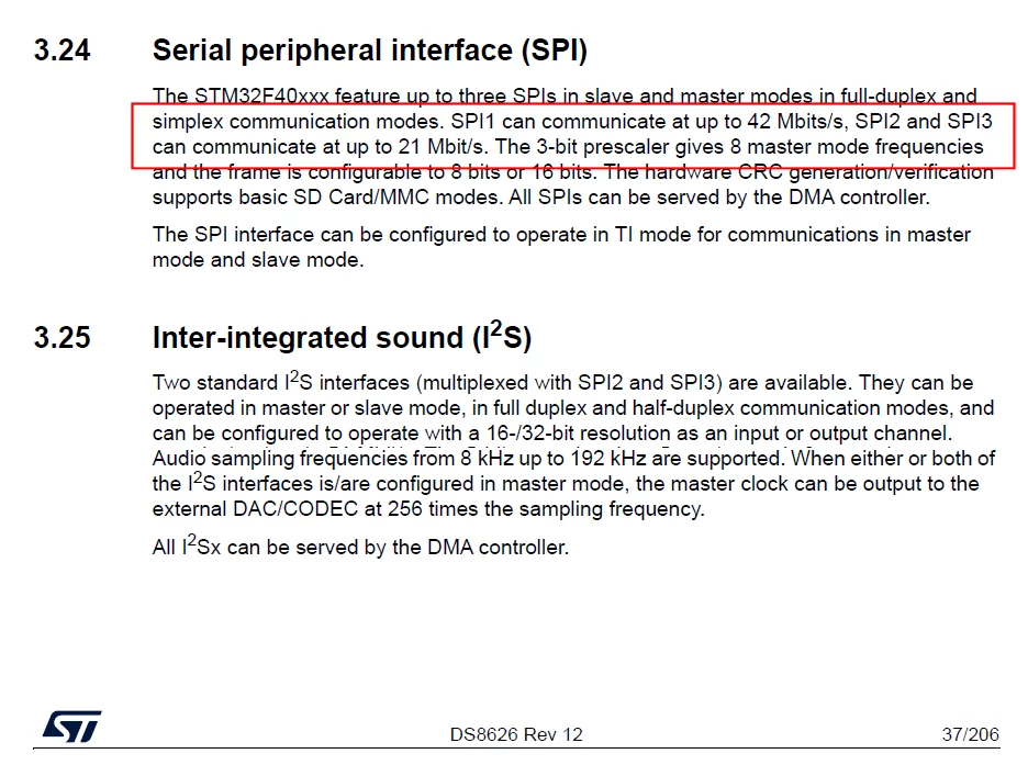

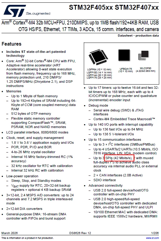

Sep 24, 2026 5:33 AM UTC
I want to use one of the SPI interfaces from STM32F405 with W5500 (W5500 Ethernet Controller: Hardwired TCP/IP Stack for Enhanced Network Stability)
what could be the maximum throughput I can achieve.
My basic requirement is 10/100 Mbps.
will this configuration with STM32F405 and W5500 works?
or, I need to go for different MCU.
Please suggest.
Mukesh
Andrew Neil
Sep 24, 2026 8:57 AM UTC
​@Mukesh Kesharwani The Datasheet tells you the maximum throughput of the SPI; eg,
https://www.st.com/resource/en/datasheet/stm32f407vg.pdf
via: https://www.st.com/en/microcontrollers-microprocessors/stm32f407vg.html
As ​@mfgkw said, that is the raw transport bit rate - the actual payload rate will be less, due to overheads.
You would need to consult the W5500 documentation and/or contact Wiznet to find what the actual achievable throughput is with the W5500 …
Again, the point of the W5500 is to make IP connections easy for chips without built-in Ethernet - so why would you use this with an F407 ?
Sep 24, 2026 5:58 AM UTC
You will reach 100Mbps in bursts while transferring from the W5500 internal buffer.
But the effective data rate will be less. One upper bound is the SPI connection, I assume around at 80Mbps. But even then you have overhead like start- annd stop bits, CPU load and more.
I would expect 50Mbps or less, even if you choose another MCU.
(The F407 internal Ethernet MAC could be a bit better btw., since the SPI throttle does not exist. But even there you will not reach 100Mbps as effective data rate.)
How to produce or process 100E6 bits per second is another question.
