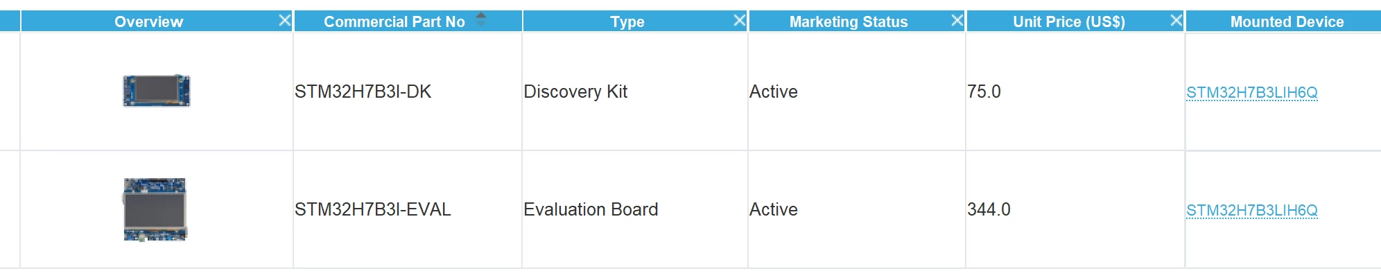

There are no ST boards with STM32H7B0VBT6.
There is a discovery board and an eval board with an STM32H73 which will be similar but with more memory.
STM32 tools support the STM32H7B0VBT6.

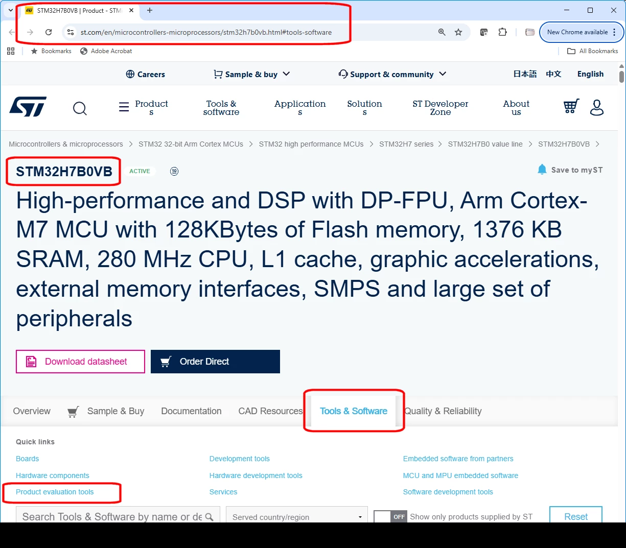

Andrew Neil
Oct 7, 2025 3:23 PM UTC
1. Go to the 'Product Page' for the chip:
https://www.st.com/en/microcontrollers-microprocessors/stm32h7b0vb.html
2. Look on the 'Tools & Software' tab for development tools - both boards and software tools:
https://www.st.com/en/microcontrollers-microprocessors/stm32h7b0vb.html#tools-software
3a. Click 'Product evaluation tools' for boards;
3b.  Click 'Software development tools' for software tools.

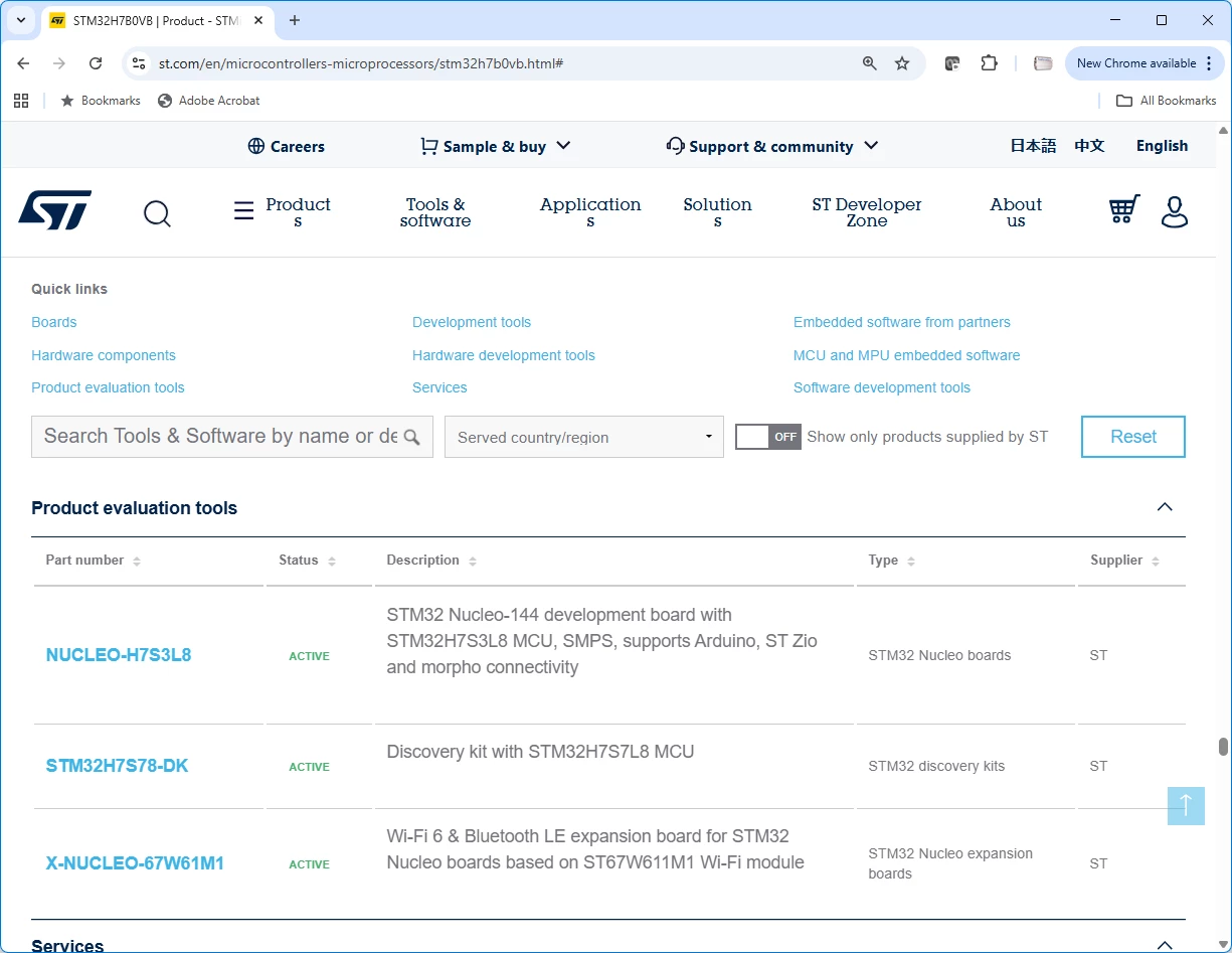

Andrew Neil
Oct 8, 2025 1:32 PM UTC
@Visitor wrote:
I am not able to find evaluation board in the link mentioned.
As I said, go to the 'Product Page' and look on the 'Tools & Software' tab:
Then click on  'Product evaluation tools' for boards - there are three listed:
