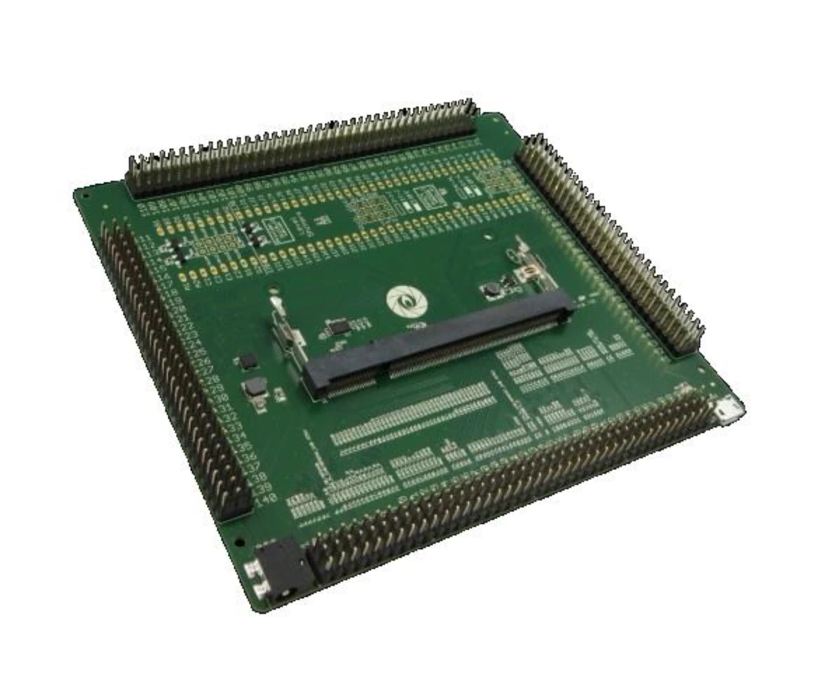

Or does anybody know of some breakout boards that just expose the GPIO pins, and maybe a power connector (just like this one for example, it exposes all the GPIO pins of a Raspberry compute module, plus it has a jack for power).
