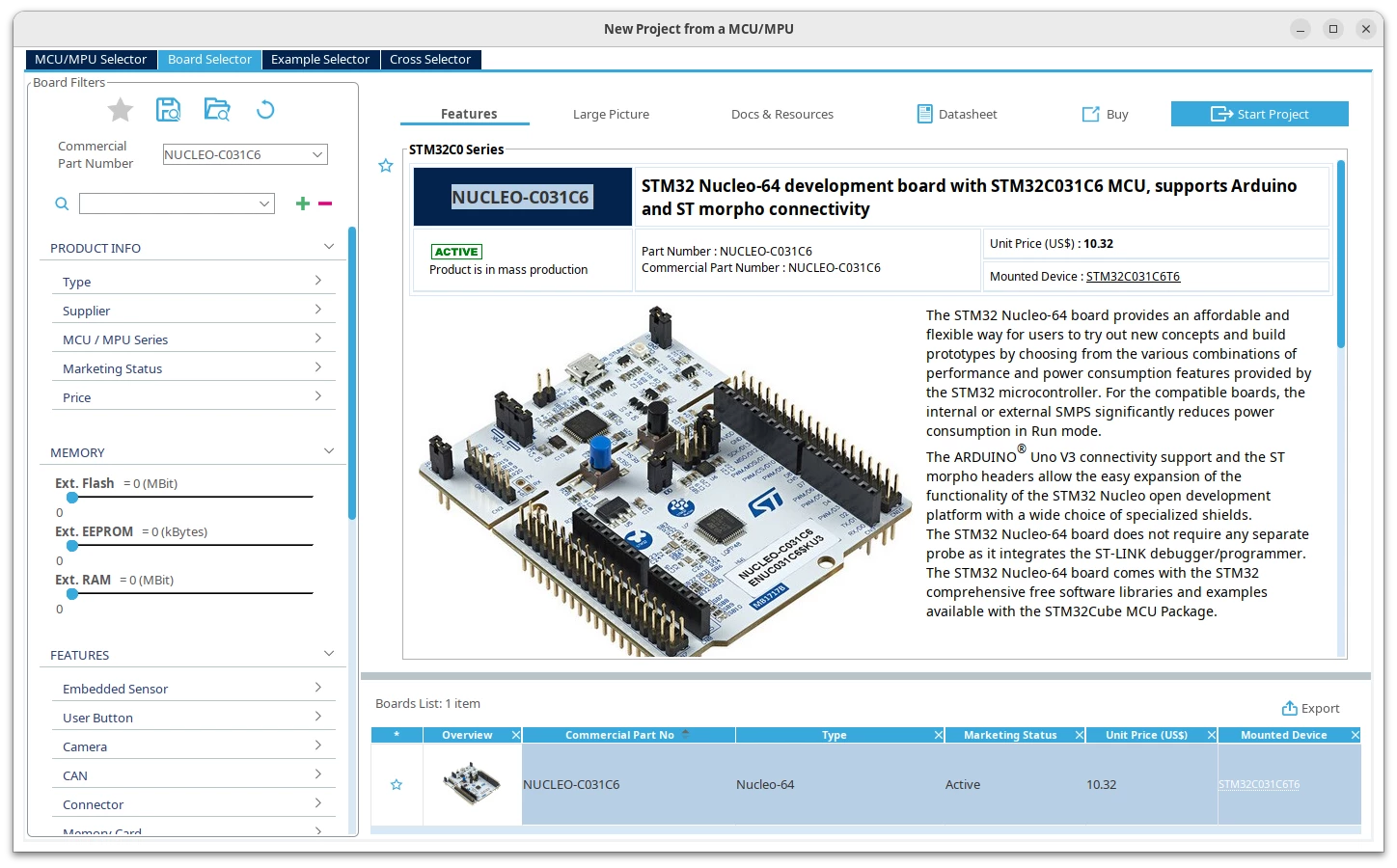

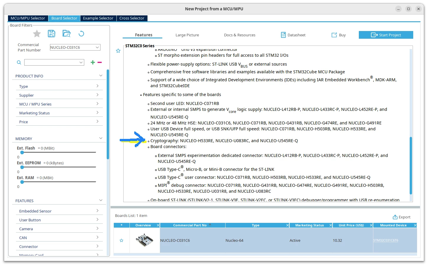

Hi @STTwo-32
In CubeMX, when reading the description of the Nucleo Board, it only says:
"Cryptography: NUCLEO-H533RE, NUCLEO-U083RC, and NUCLEO-U545RE-Q"
I didn't understand if it's a comparison, that is, other Nucleo board has the resource as in the suggested µC, or if one of these is present on the board.

Could you please be more specific. Maybe the screenshot helps.

carlosdelfino
Senior
January 19, 2025
Captura de tela de 2025-01-19 17-43-03.pngCaptura de tela de 2025-01-19 17-42-40.png

STTwo-32
January 19, 2025
This is a global description that tels the user that in some of our NUCLEO boards, we may have some features that you Will not find in other board such as the Cryptography. To know if a specific board does have a specific feature (such as crypto) you may use the methode that i have Said on the first commant.
