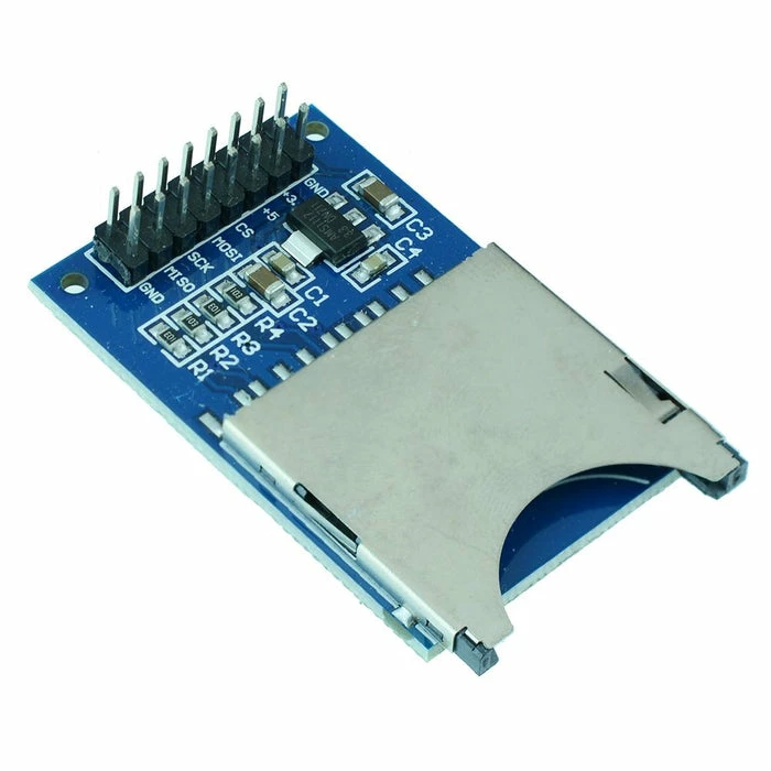

which STM32 dev kit (preferably STM32L4 family if available) has a MicroSD card reader that uses standard SPI (i.e. not Quad SPI)?

The headers on Nucleo boards are Arduino compatible so, if you can't find a native one, you could fit an Arduino SD Card shield (taking care that Nucleos are all 3V, not 5V).
Or simply wire something like this onto any board:
@Ricko wrote:
Also is there a selection tool that allows you to specify the type of SPI or at least whether it has Micro SD?
You can easily get adaptors to micro SD cards into "full size" sockets - so it shouldn't really matter?

They had an Adafruit shield, with an SPI MicroSD card, so code support in BSP Components and related to NUCLEO's
https://github.com/STMicroelectronics/STM32CubeL4/blob/master/Drivers/BSP/Adafruit_Shield/stm32_adafruit_sd.c
