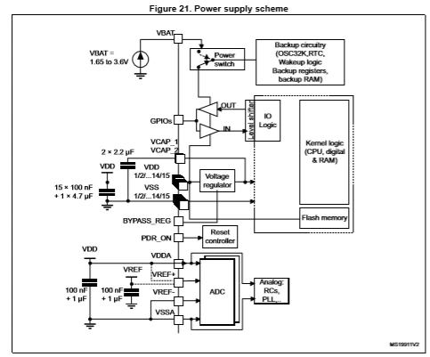

Decoupling capacitors in STM32F4 scheme.
 Are the VCAP_1/VCAP_2 external capacitor decoupling capacitors ?  (when using the 2.2 uF with power regulator ON)
PowerSupplyScheme page 77:
Uwe Bonnes
Uwe BonnesBest answer
Chief
Apr 24, 2020 10:02 AM UTC
Yes. The MCU generates its own vore voltage and this voltage _needs_ decoupling.
