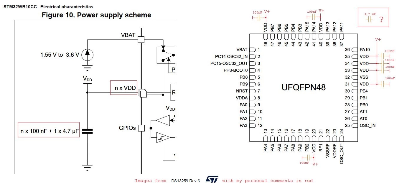

I am currently optimizing some designs and started thinking about decoupling capacitors. As far as I know, it is a rule of thumb to place "one 100 nF capacitor per V+ pin".
In the attached document, ST recommends exactly this. Let´s look at the document: n x 100 nF + 1 x 4,7 uF. I interpret this in the following way: For each VDD pin, I have to place one 100 nF capacitor (as close as possible to the pin) and, overall, I need an additional 4,7 uF capacitor.
Now two questions arise:
-If you look at pins 33, 34 and 35, do I really need three single 100 nF capacitors? Couldn´t I just place one 300 nF in the middle? Or maybe one 100 nF would also suffice?
-Where do I place the 4,7 uF capacitor? The pins are quite far apart. Do I just place it "somewhere"?
I think I understand the theory that the capacitors serve as an energy buffer when the uC has transient changes in current draw and that they filter out high frequency spikes on the traces.
I have a two layer PCB and I am looking for a practical answer for this particular case.
- The Capacitor has a resistor inside so this is a difference for 3x100nF and one 300nF because one 300nF is a single resistor series to capacitor and 3x100nF are 3 resistor parallel which it is lower than single one.
- on somewhere has more pin connected to it because it usually has more space and lowest resistance between capacitor and controller.
AScha.3
Sep 16, 2023 12:40 PM UTC
- if enough room, place 3 x 100n . or 1x 100n, if no space.
- the 4.7u where you bring all vcc lines together

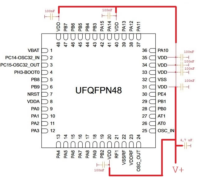

Ok, so to summarize:
As I don´t have the software for a simulation, I will stick to the recommendation and use 1 nF capacitor per VDD pin, even if that means that I have three capacitors in close proximity to each other. The board space is sufficient for that placement.
The 4,7 uF capacitor will be placed either where I tie the VDD lines together or in the area where there is most "demand".
like this?

that can be like that but if it's possible that the power line should not be like a L or C or U shape because that 's going to generate some magnetic field and it can induce the other track.
and the controller should not place in middle of power line path, it 's should be end point of power line to reduce current pass through them.
there are some considering on design.
