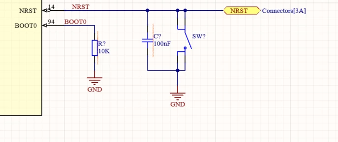

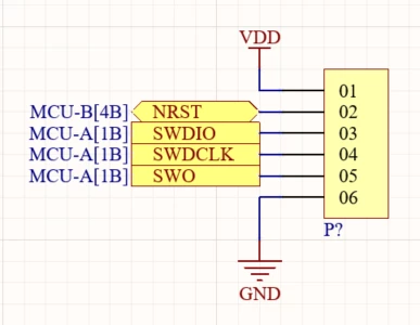

I'm a beginner to designing stm32 hardware designs. I need to program my STM32F413VGT3 microcontroller using SWD(Serial wire debugger). Also I need to use SWO option. I designed a circuit for this.
1. I want to know about can I use SWO with SWD interface?
2. Is my circuit(attached) is correct? (I'm not sure that 50ohm resistors and 100K pullup resistor)

Yes I familiar with development boards. I checked my project using a Discovery board. But now i need a build a custom circuit.
I designed this circuit using the Application notes, data sheets. Now I need to verify that is my wirings are correct?
Also I want to know about can I use SWO with SWD interface?
Thank you.
You could answer that by trying it on the Disco board ...
