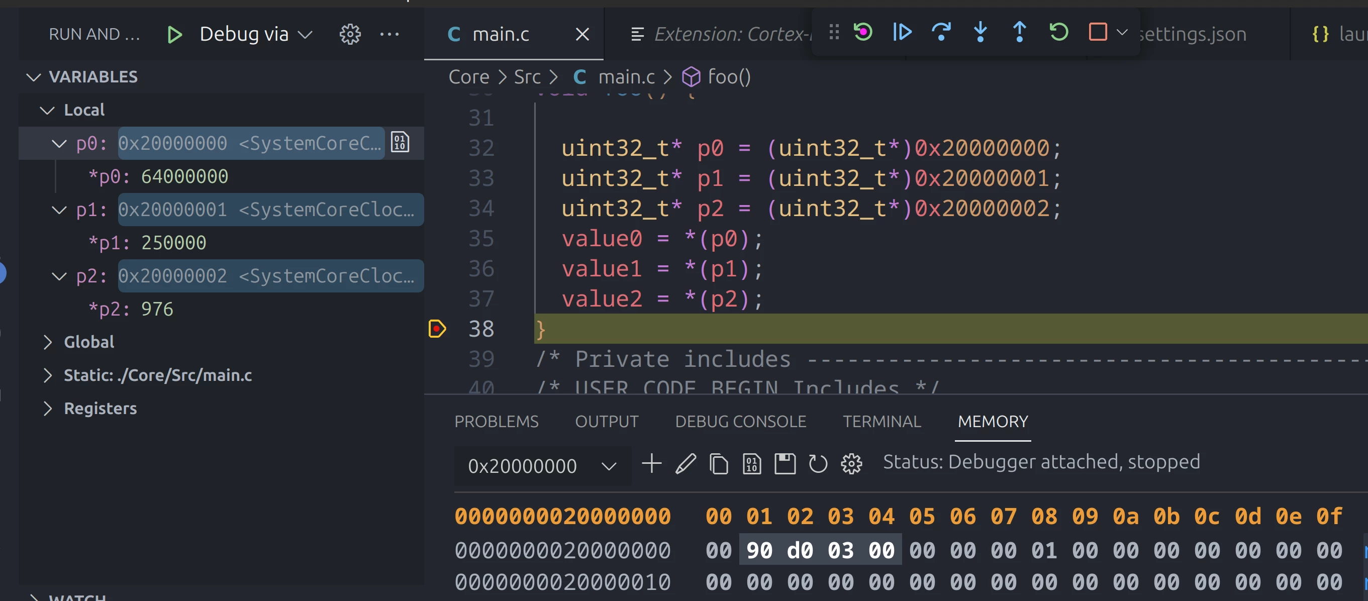

I am trying to understand the memory on my STM32F302R8
Looking in the manual I understood the SRAM to be at 0x2000 0000 - 0x2000 3FFF
This is the first time I have used VS Code for Cortex and understood that I would be able to view this using the Memory View pictured below
I might be doing this wrong but I did expect the view to match the watch.
Thanks all.

The windows do match. 64000000 decimal is 0x03D09000, shown in the memory view but it looks different because the MCU is in little-endian mode. And so on...
hth

June 17, 2023
I feel as stupid as a photocopier. You don't get much free time to do your own projects. Thanks this is great. Shame you cannot edit with cortex-debug yet but vs-code is so nice to use.
