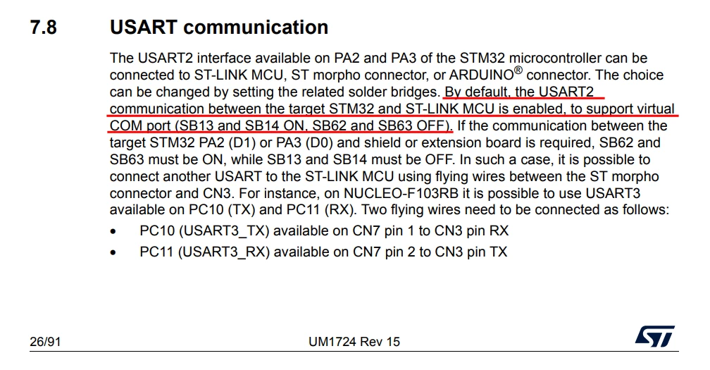

So are you using the on-board ST-Link's VCP (Virtual COM Port) for sending & receiving?
This does use USART2 by default - so be sure that you (or any previous users of this board) haven't changed any links. Also that no "shield" is connected which uses these pins:
