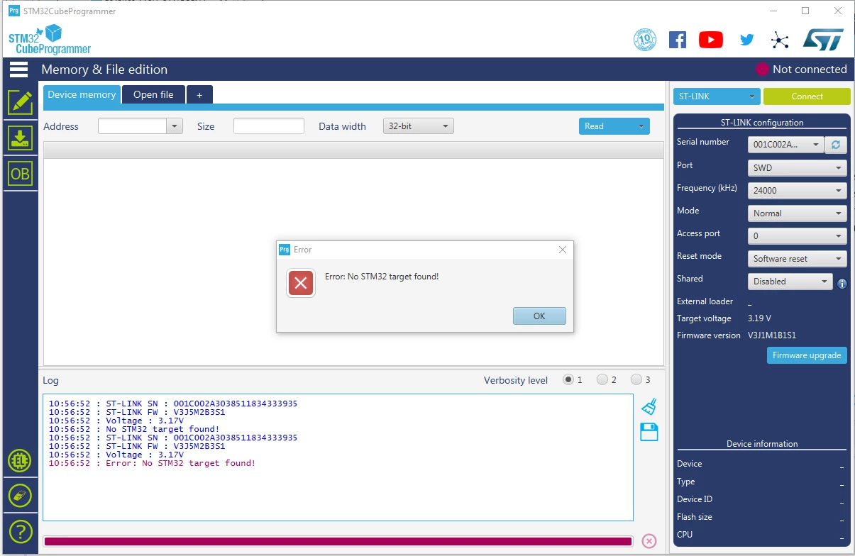

I want to program (first time) an STM32F042K6 with STLINK-V3SET using SWD.
When I try to "connect" with STM32CubeProgrammer, I get these informations : "Error : No STM32 target found!". Here is a screen :

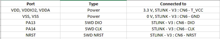

The connections are :

It could be a connectivity issue, especially if you haven't qualified the hardware yet.
For CM0 parts would suggest trying 4 MHz connect speed rather than 24 MHz​

Hi Clive, thank you for you answser.
I tried all frequency (from 5 kHz to 24 MHz).
You're definitely right, I'll check again the welds. Do you think my connections are correct ?

Hi Uwe Bonnes, thank you for you reply. I got the solution : the connections are correct but one pin was not welded correctly.

Mar 10, 2020 10:54 AM UTC
To conclude with my question : the connections (see tab above) are correct.
We do not need to enter in bootloader mode, so PB8(BOOT0) does not need to be set.
One pin was not welded correctly.
