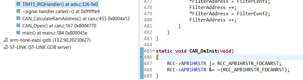

I'm developing a software on the STM37H753ZIT nucleo board, I place some time critical functions inside the ITCMRAM to improve performance, the code is correctly running and the behaviour meets the expectations execpt for a fact:
When I place a breakpoint to stop inside a function located in ITCMRAM, the debugger stops in another place:
Here an example is provided, the function placed in ITCMRAM is TIM15_IRQHandler, when I try to stop inside the function the debugger stops in CAN_DeInit, that is a function never called in the code.
Note: Rebuilding and relauncing the project, brings the debugger to stop in another place, different from CAN_DeInit, but still stops in unused code piece.
Does anyone knows why this happens?
Thanks in advance,
Luca

I solved the problem changing the linker script and placing starting position of ITCMRAM to 0x400, because I declared the NULL pointer as pointer of 0x00 so I think this was the problem.
Regarding the ITCMR Linker and startup implementation I follow this tutorial:
