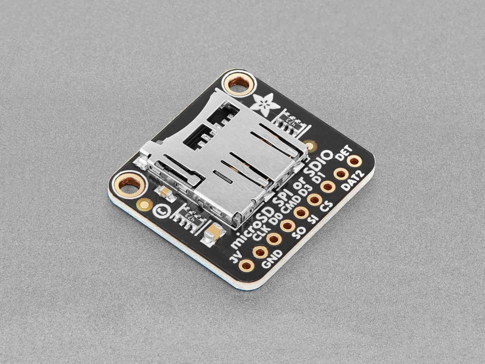

I'm using the SD card breakout board by Adafruit so it comes with the pull-up resistors and all, so that's unlikely to be the issue here.

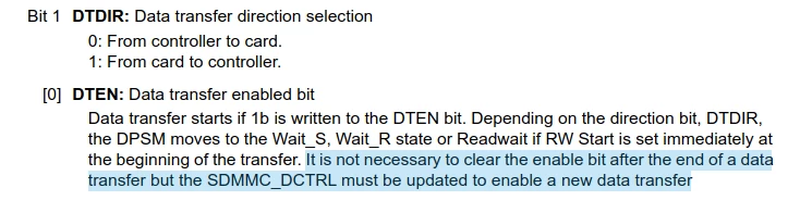

What seemed to fix the issue was disabling the Data Path State Machine (DPSM) via clearing the DTEN bit in SDMMC_DCTRL after I had finish doing a transfer. This was strange, as I was expecting the DPSM to automatically disable itself after the entire transfer was complete. I'm referring to RM0351 Rev 10 January 2024.

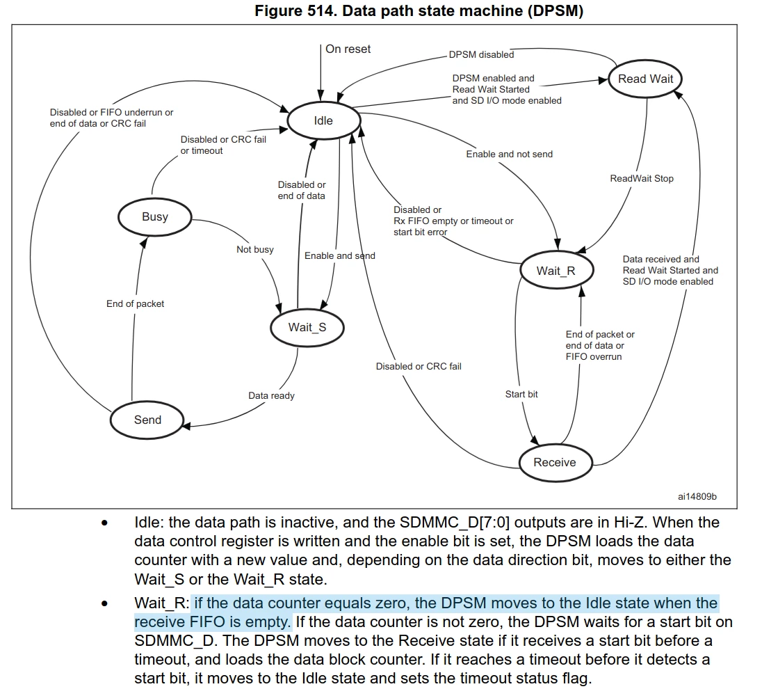

My understanding is also backed up by Figure 514. Wait_R is where the DPSM would end up after receiving the 512-byte data block (coming from Receive), and it should then transition to Idle when SDMMC_DCOUNT reaches 0 and I have read everything from the RX-FIFO.
I'm not sure if it's a bug in my own program or something else, but I'm having it where RXFIFOE ("is RX-FIFO empty?") is not set despite the fact that FIFOCNT (remaining words in FIFO) is 0. Maybe because of the fact that RXFIFOE is never set, there is never a transition from Wait_R to Idle, thus the DPSM is never disabled?
If this does happen to be some sort of errata, then my current workaround of disabling the DPSM after the data transfer seems to be sufficient in removing the contention between SDMMC and the SD card.
